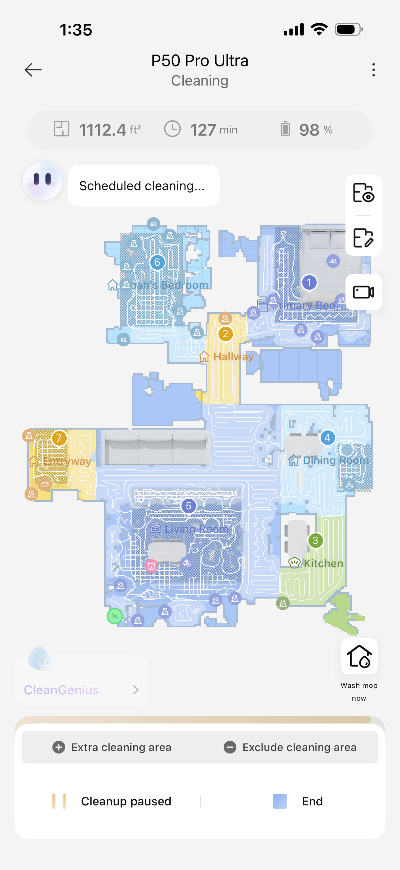

When first got p50 ultra it would run at its scheduled time every day. But now only after having the vacuum for less then 4 months it continues to report that the job has been completed prior to it even starting.  I then have to go in and manually start it run the cleaning cycle.  What is the purpose of having it setup on a daily schedule if it doesn’t start.
I have gone through and cleaned and checked all the parts. Replaced what could be replaced an still no change, it will not start on schedule.
this issue is most likely caused by an abnormal map near the base station, which prevents the robot from starting the cleaning task properly.
Please check whether there is a carpet or any other obstacle placed in front of the base station. You may also upload a screenshot of the current map to help us further assess the situation.
Alternatively, you can try recreating the map to see if this resolves the issue.
2026-3-30 15:16:25 US Translate
EV795168Thread Starter
This is a map of the rooms that it should be cleaning.  The objectives that are close to the start get pick up at the beginning but sometimes the dog brings them back.
