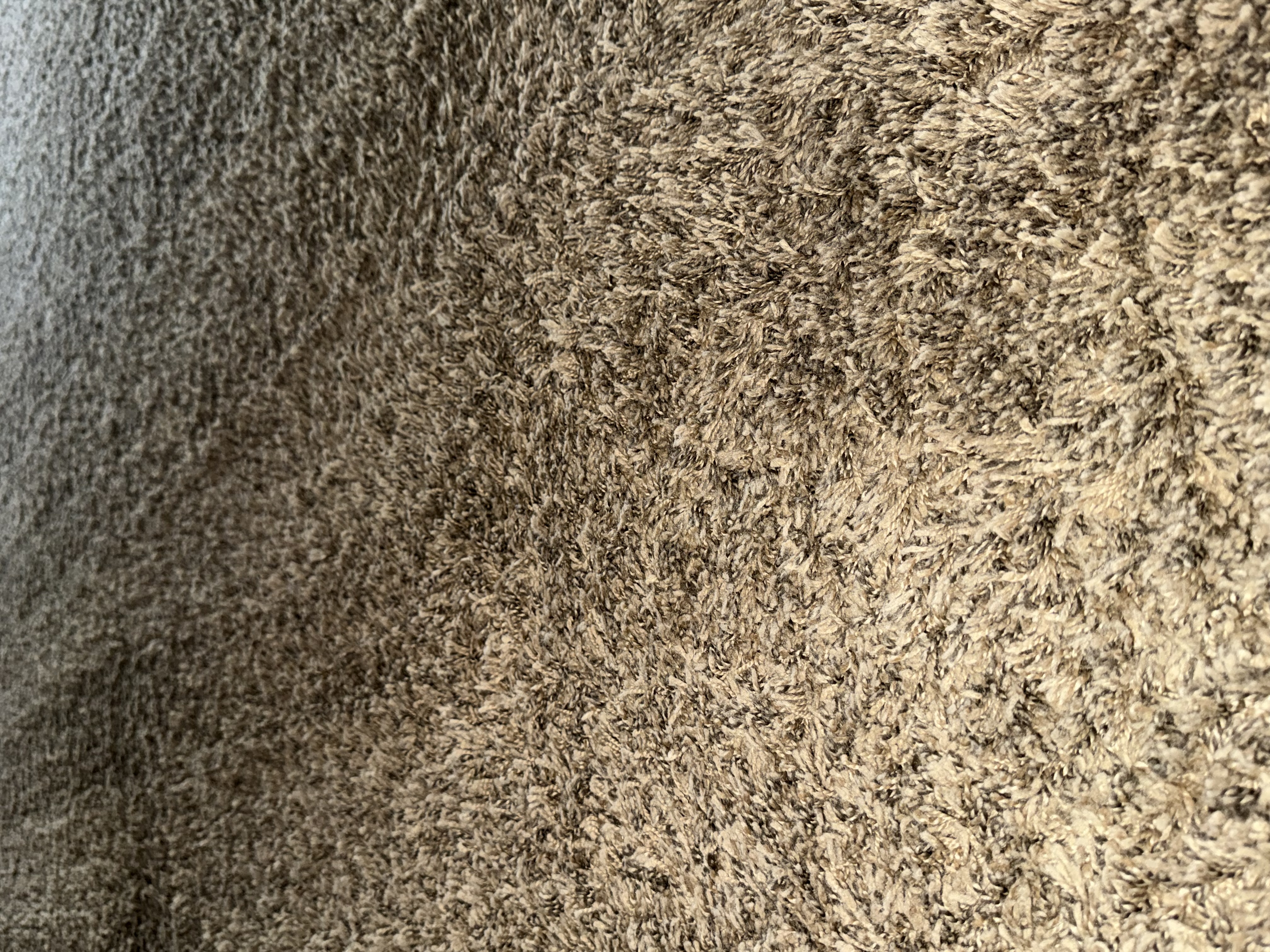

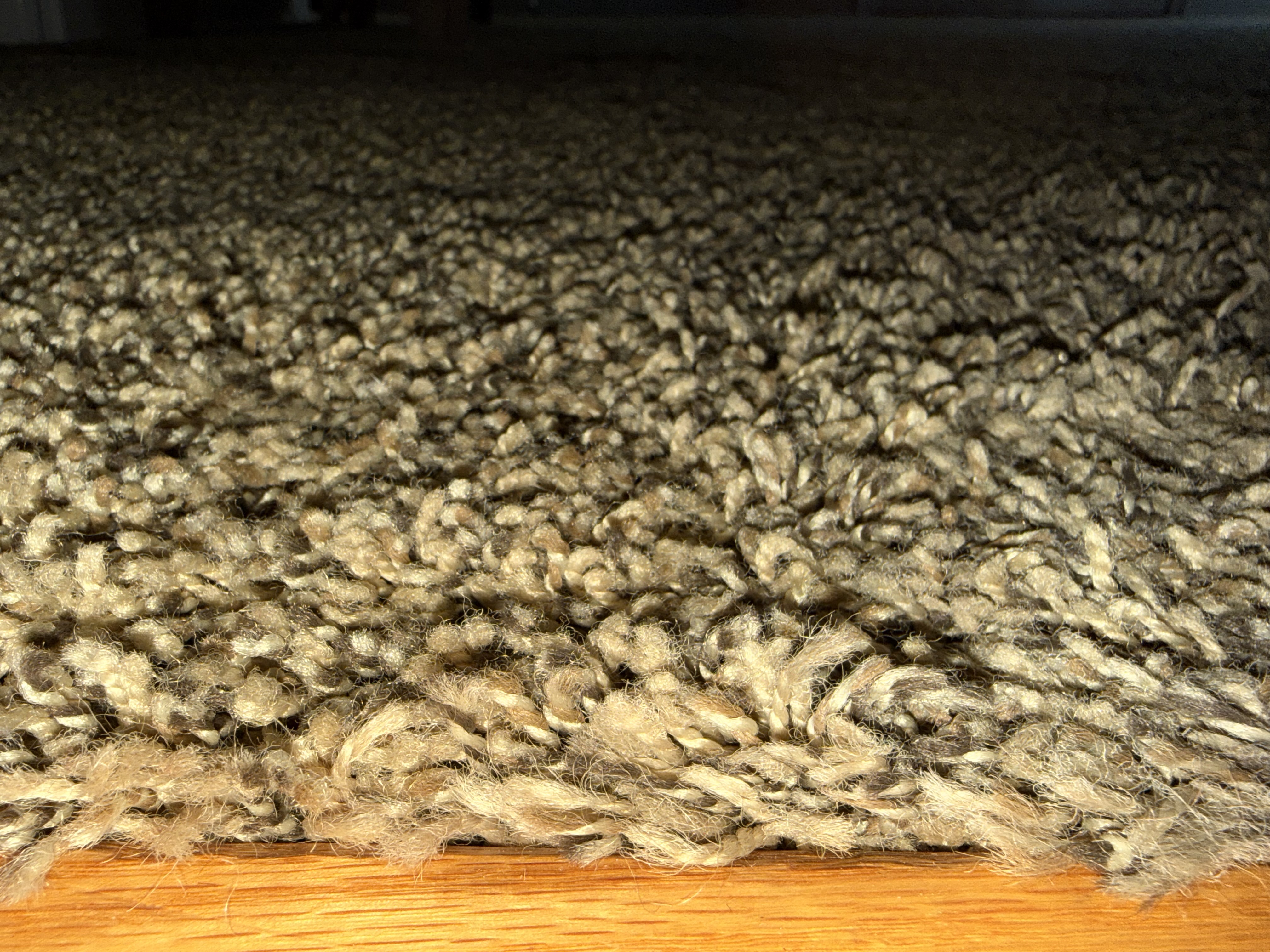

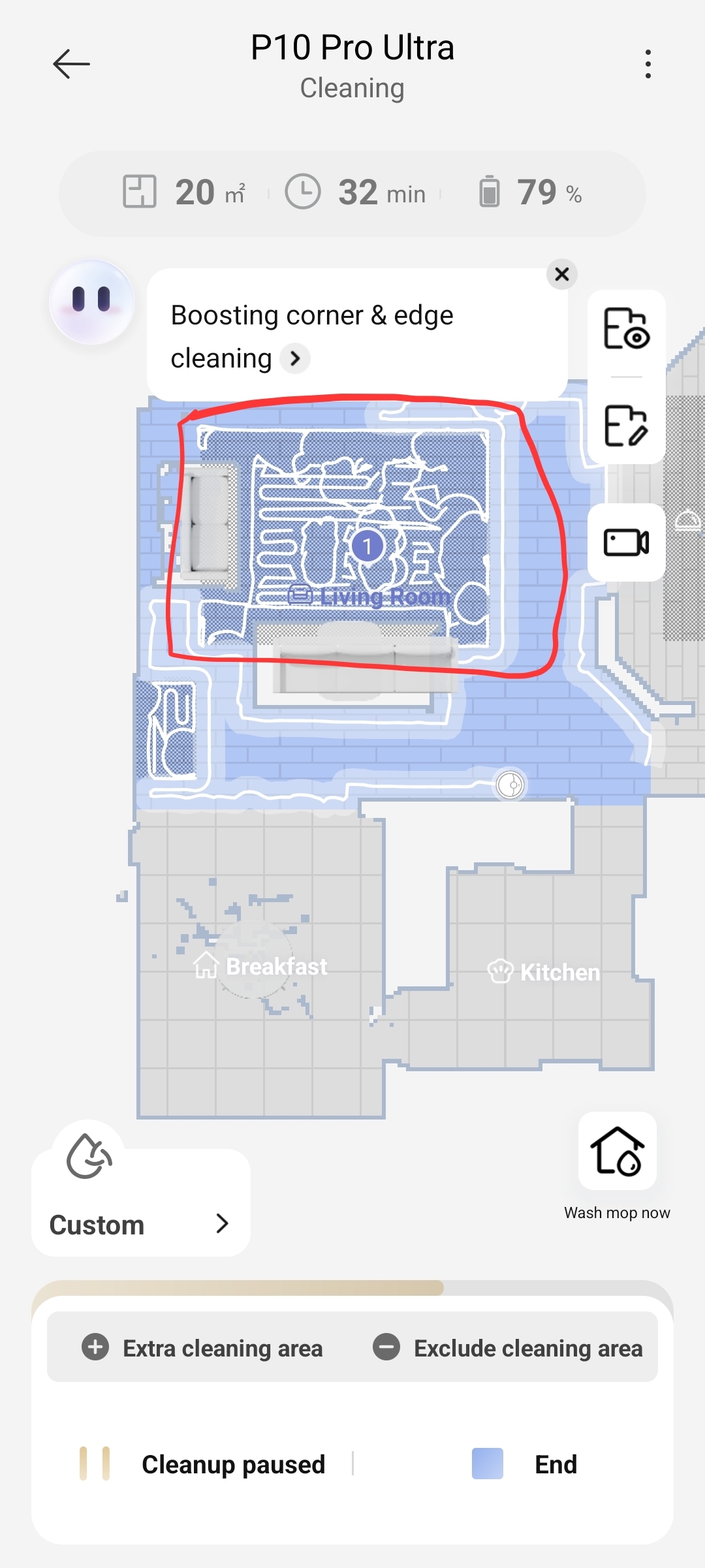

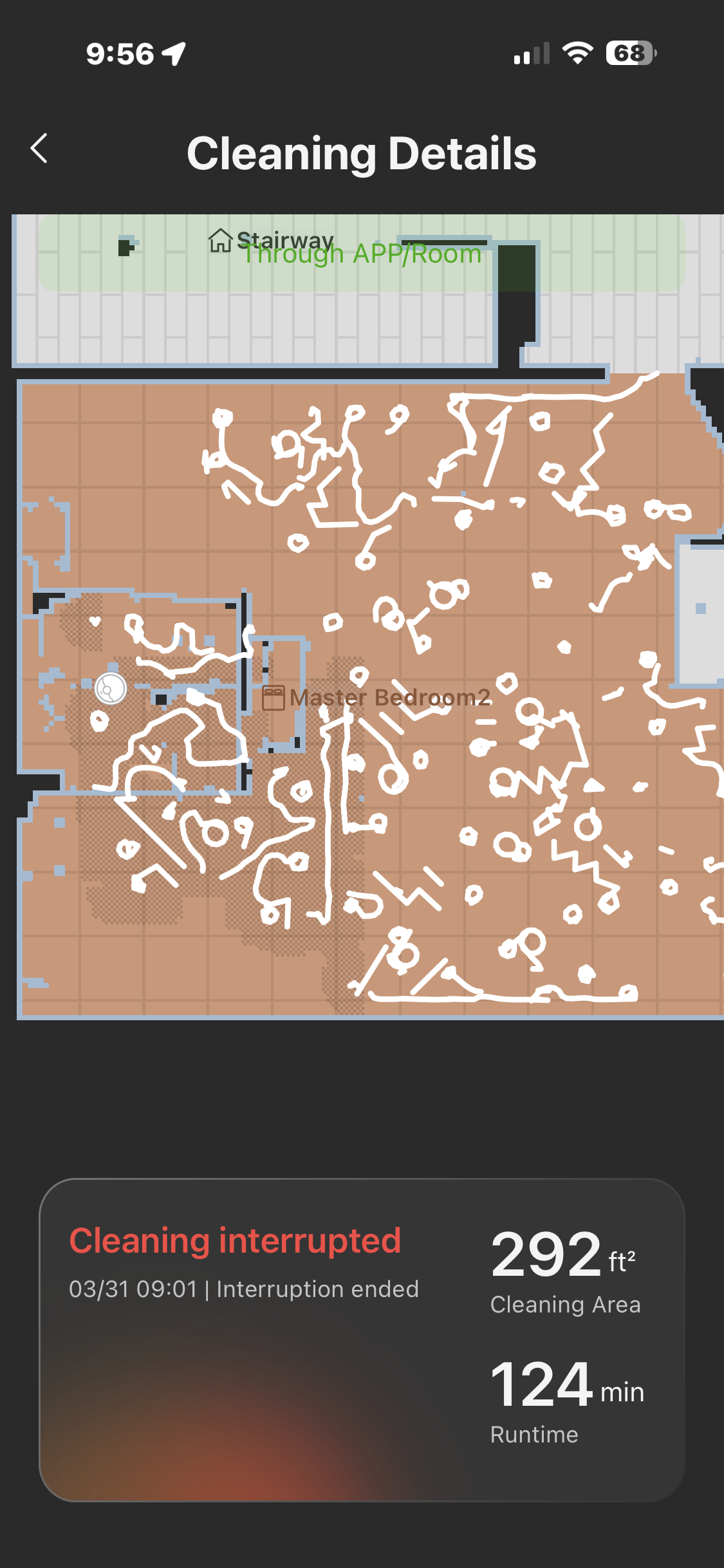

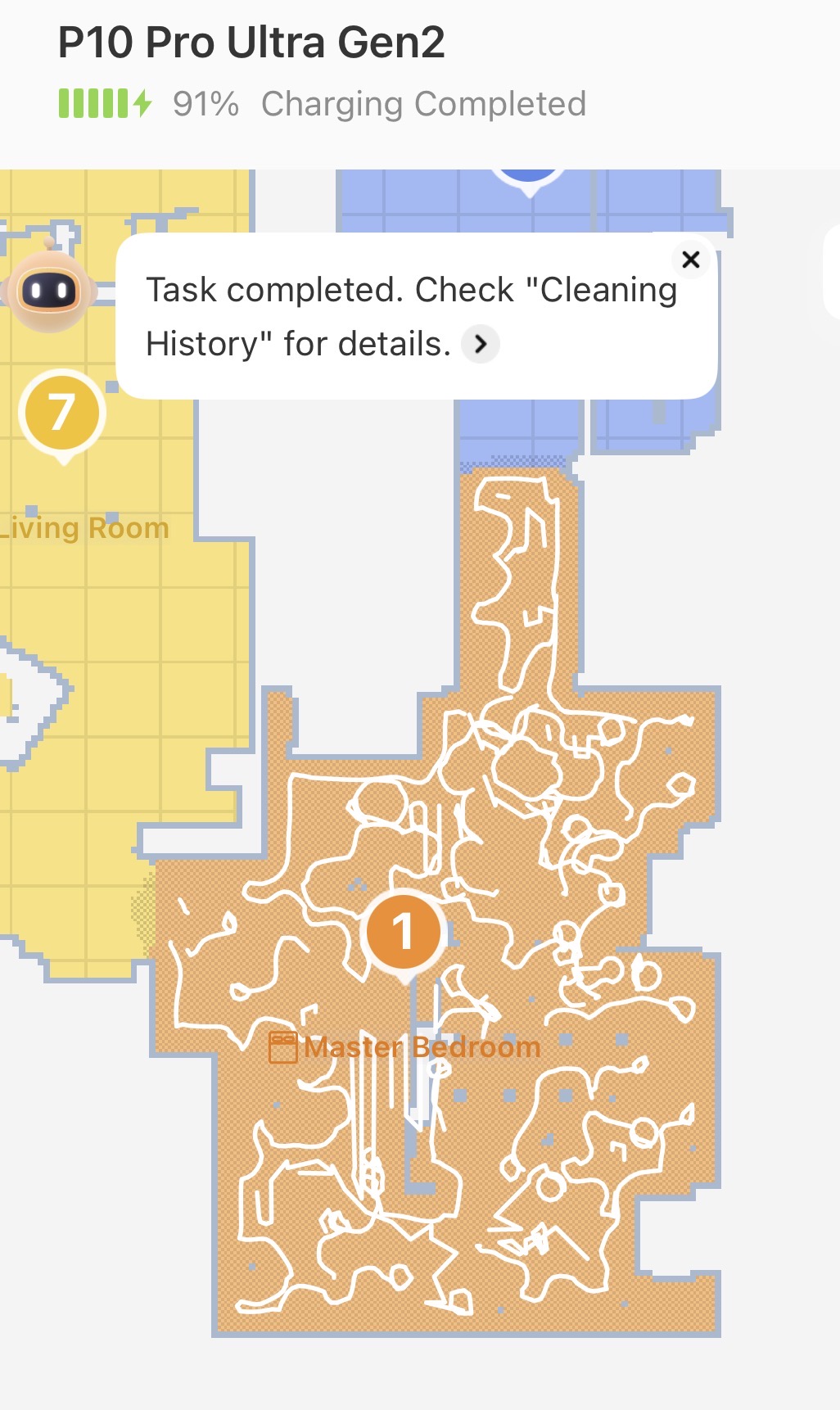

It’s not funny at all but this is the funniest thing… I can only imagine what the robot looks like doing this. Sorry you are experiencing this!
2026-4-2 05:53
We recommend testing the robot on a carpet with a thickness of less than 2 cm to see whether the issue still occurs.
2026-4-14 15:18
thank you for your reply.
This may be caused by the carpet being too thick. The mop lifting height of this model is 10.5 mm.
2026-4-14 15:18
general carpet settings in the main settings menu, we recommend tapping the carpet area directly on the map to adjust dedicated cleaning settings for that specific carpet zone.
If carpet boost suction is enabled but the robot still cannot vacuum properly, please remap your house and manually add the carpet area again to see if this fixes the issue.
In addition, the robot will not vacuum carpets if the selected cleaning mode includes a mopping task.
2026-6-29 13:59
Hello, thank you for your reply. This problem may be caused by an overly thick carpet. The mop lifting height of this robot is only 10.5 mm.
Due to its limited undercarriage clearance, the robot may take irregular cleaning paths, get tangled with hair or have unsatisfactory cleaning results when cleaning long-pile or dark carpets. We suggest marking such carpets as restricted zones on the map. You may test the robot on carpets thinner than 2 cm to see if the issue remains.
