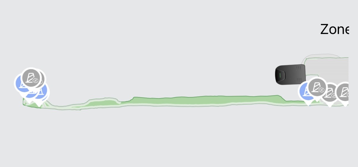

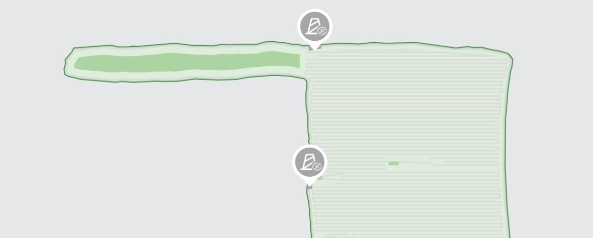

Can anyone can help with the mower did not mow the middle section of the side yard please? It just did the border and finished.
Thank you!
If certain areas are inaccessible due to obstacles, the robot may determine that the mowing task has been completed.
If the narrowest width of the area is more than 60 cm, it can be included as part of the normal mowing area. However, if there are passages with a width of 60 cm or less, the robot will not be able to mow them automatically.
In this case, we recommend dividing the lawn into multiple areas and setting those passages with a width of ≤ 60 cm as corridors. You can then use the manual mowing mode to periodically trim these corridor areas.
