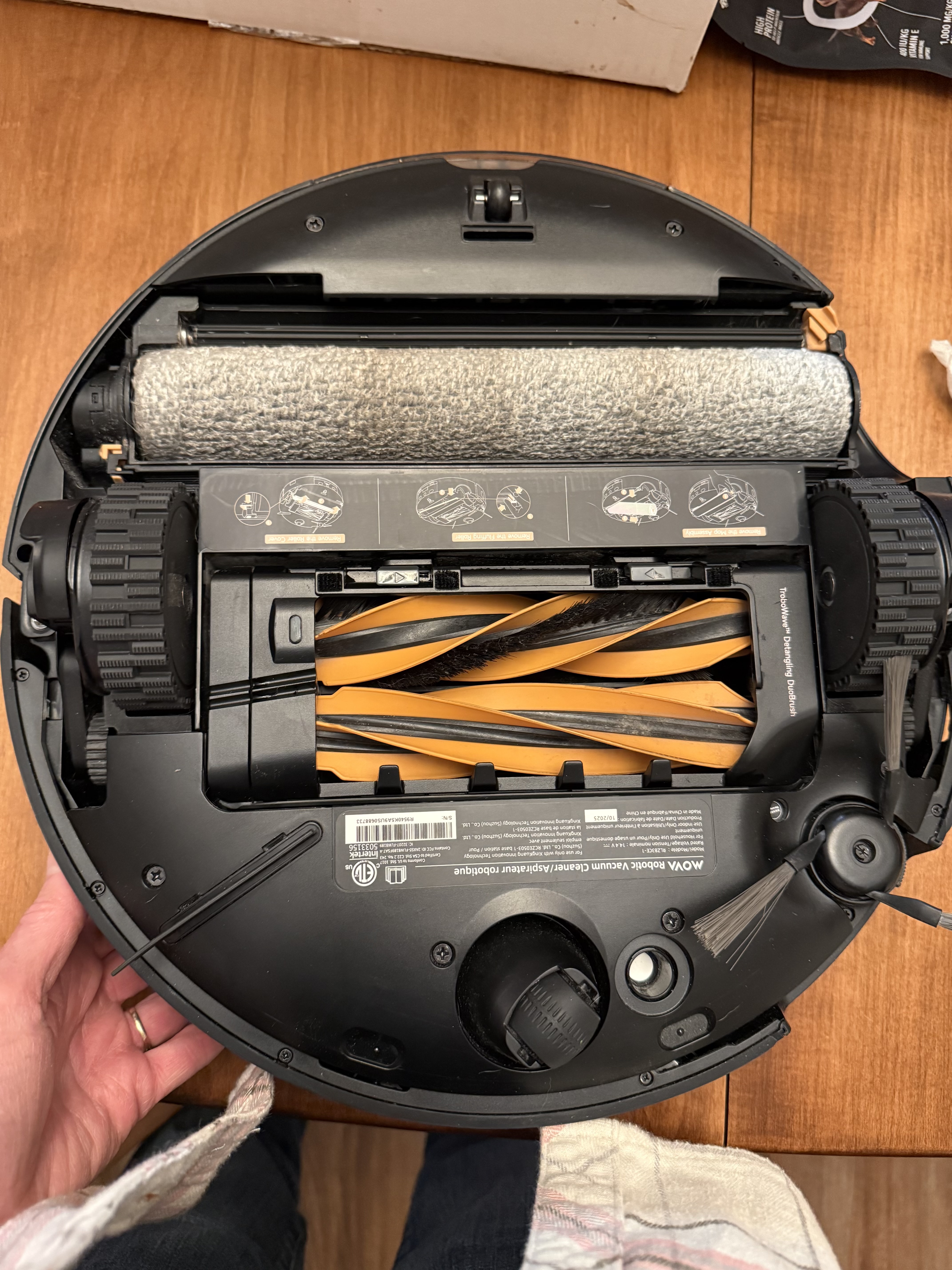

Based on the smell that came out of the machine when it was emptying I fully expected to find a very dirty machine.  I was actually amazed at how little dirt, hair and fur was actually still in the robot.  The majority of the dirt made it into the dust bag.  The first photo shows the underside of the robot before I started cleaning.

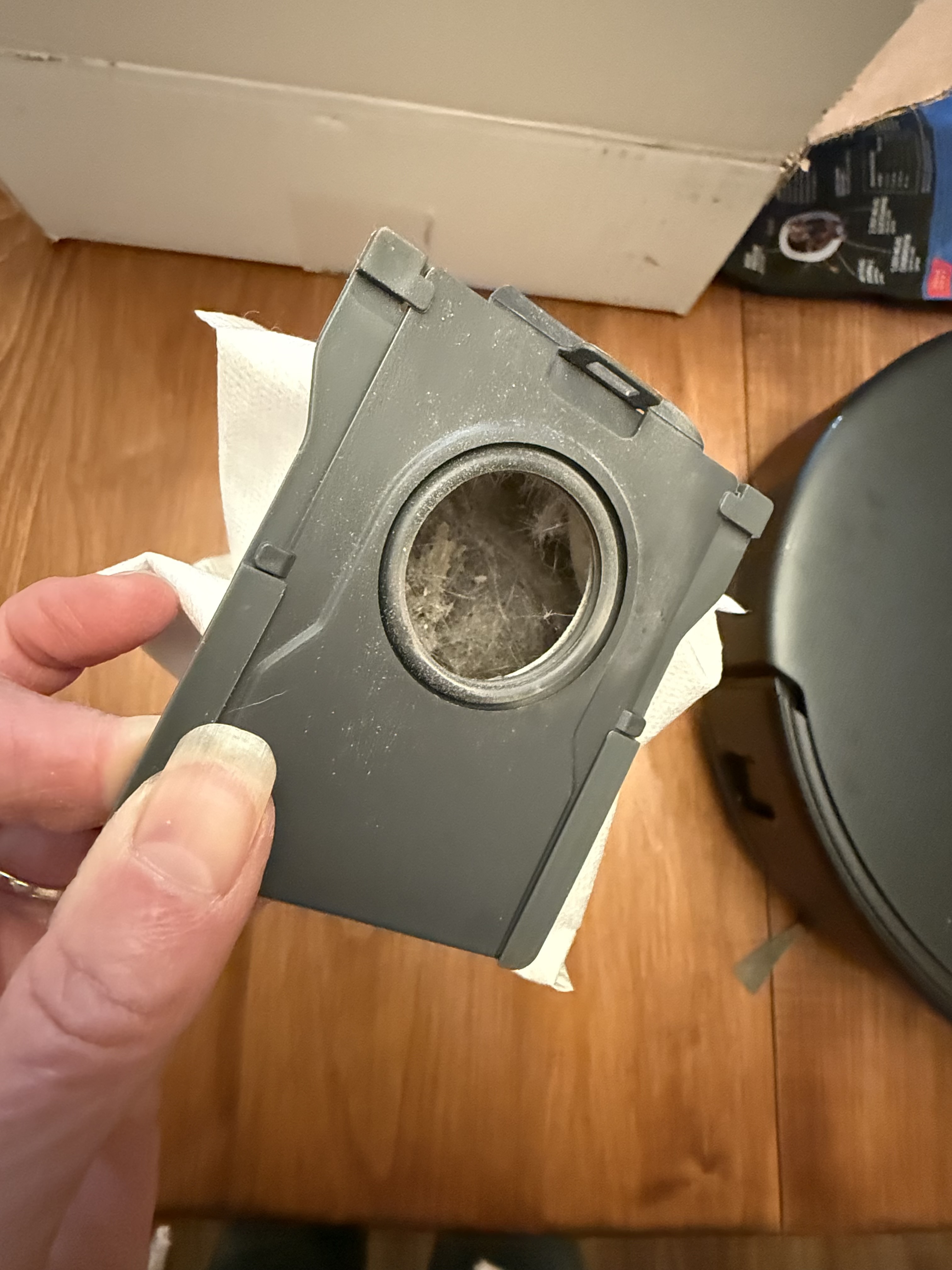

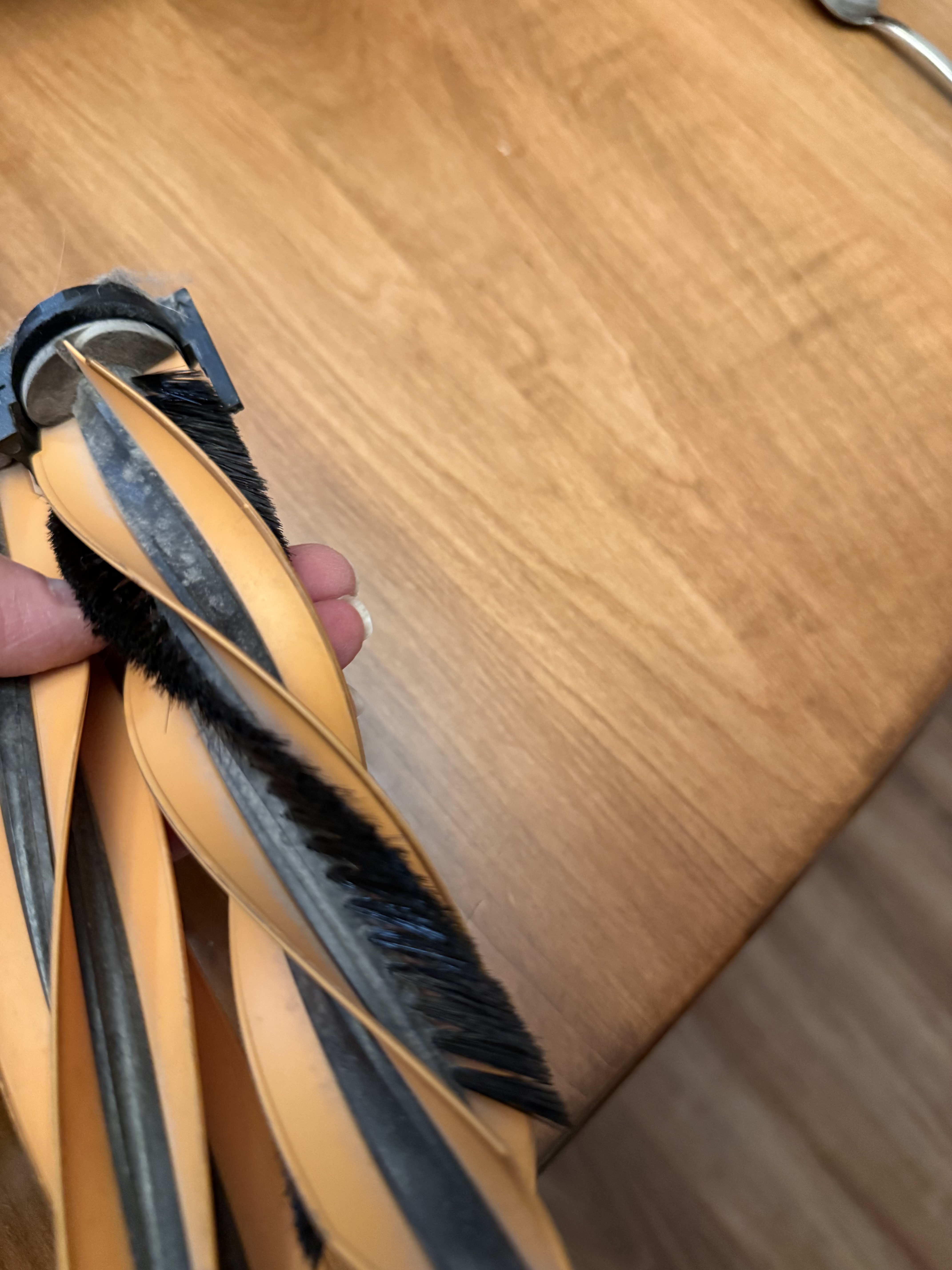

The washboard was pretty dirty, but it rinsed off easily.  The dust bag was not completely full, but I would say at least 3/4.  It definitely is picking up a lot when vacuuming.  There was no hair tangled around the side brush or main brush at all.  The main brush was dusty, but a slightly damp paper towel cleaned it right up.  Under the main brush was some fur and dust, but again, a damp paper towel took care of that.
The filter in the dust box was very dirty.  Since it has to be completely dry before returning to the Z60, I got a new filter to install.  I rinsed the dirty filter and it  cleaned up really well.  I will let it completely dry and then put it back in my supplies for next month.  My intent is to rotate these 2 filters monthly so that one can be washed and thoroughly dried before re-using the following month.

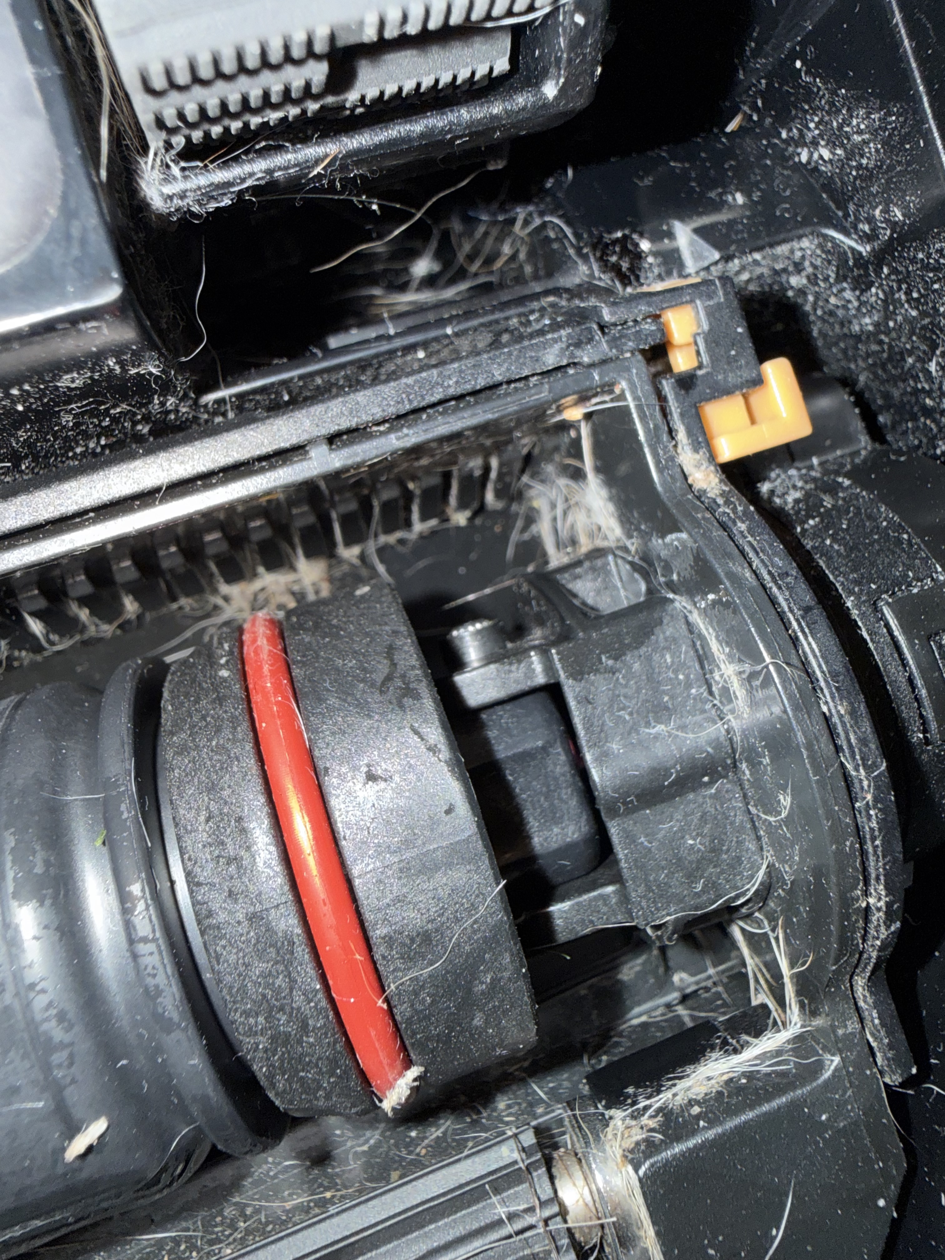

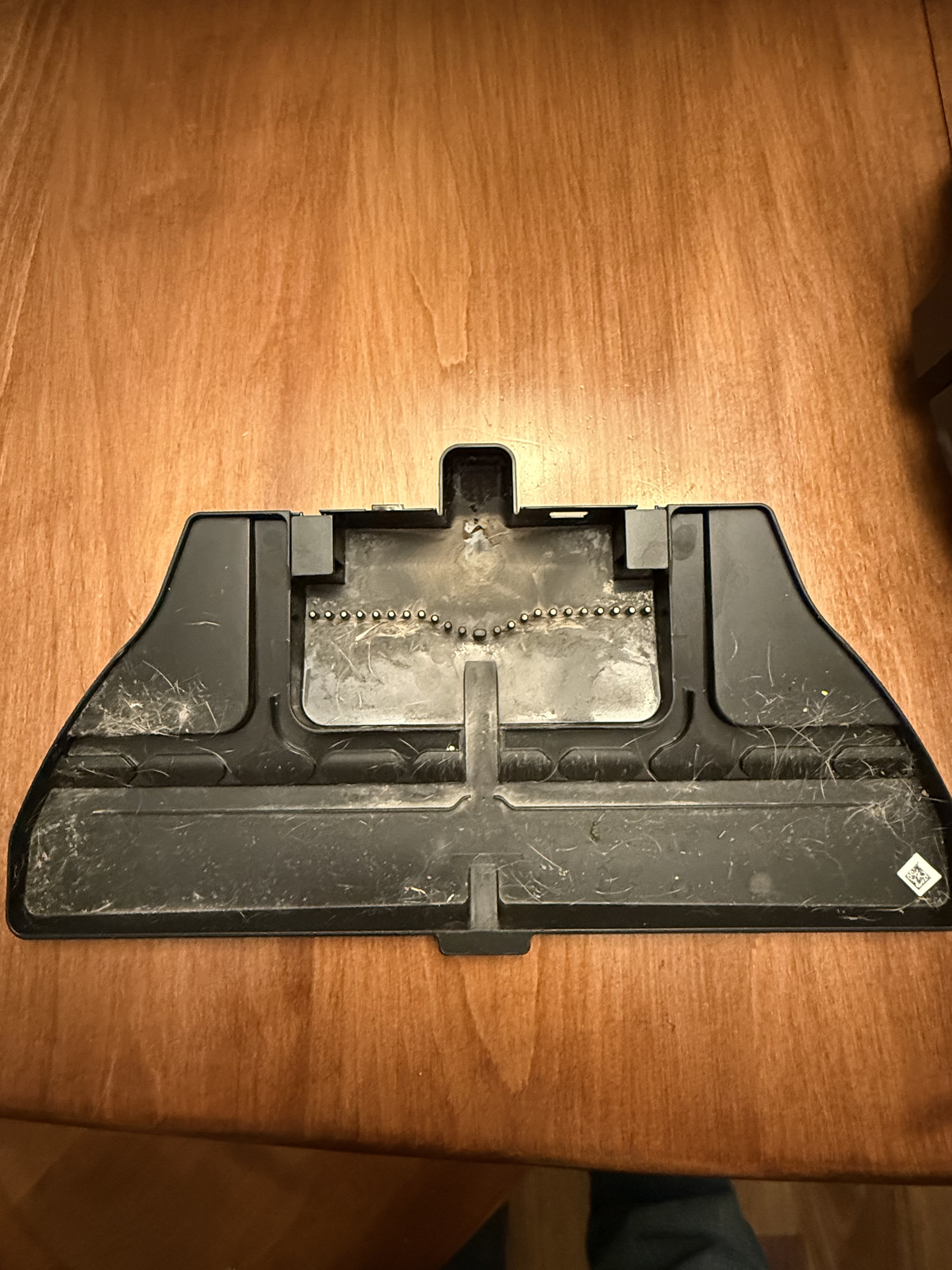

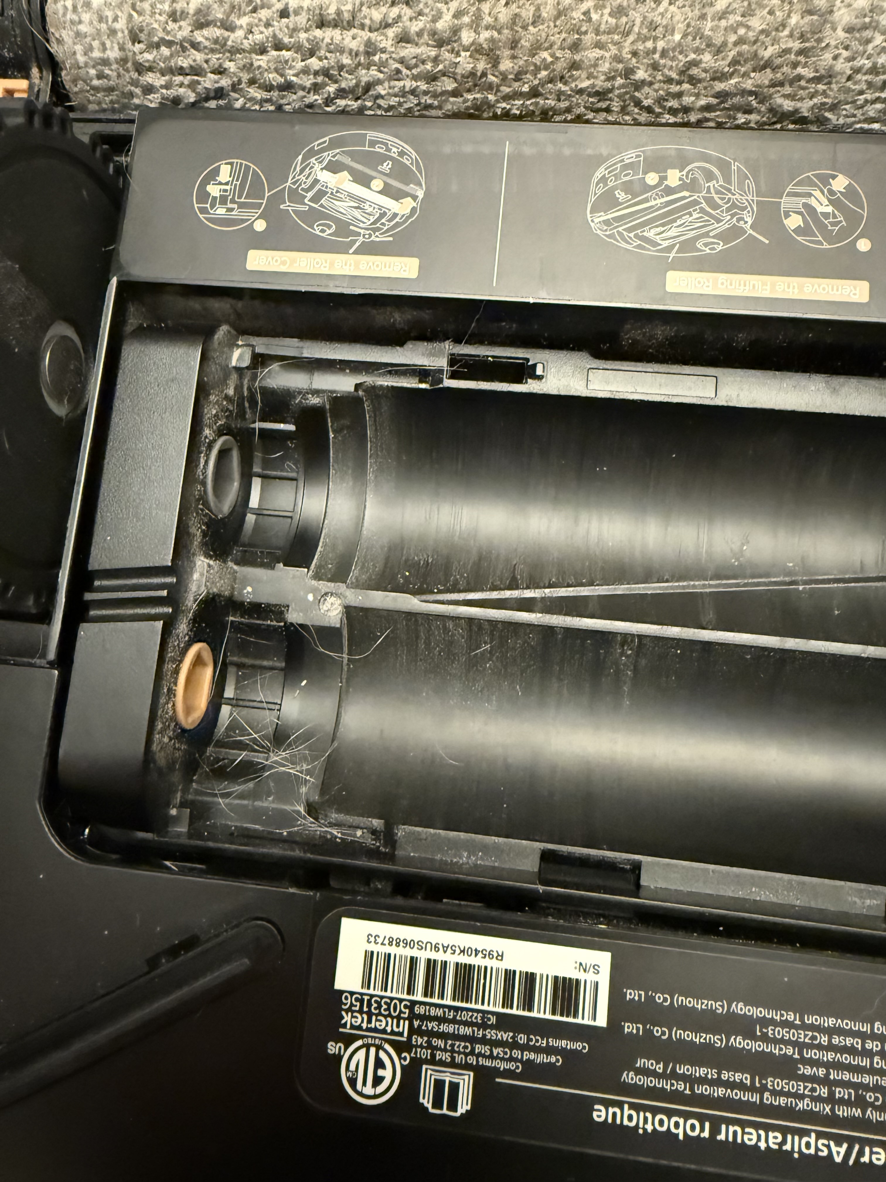

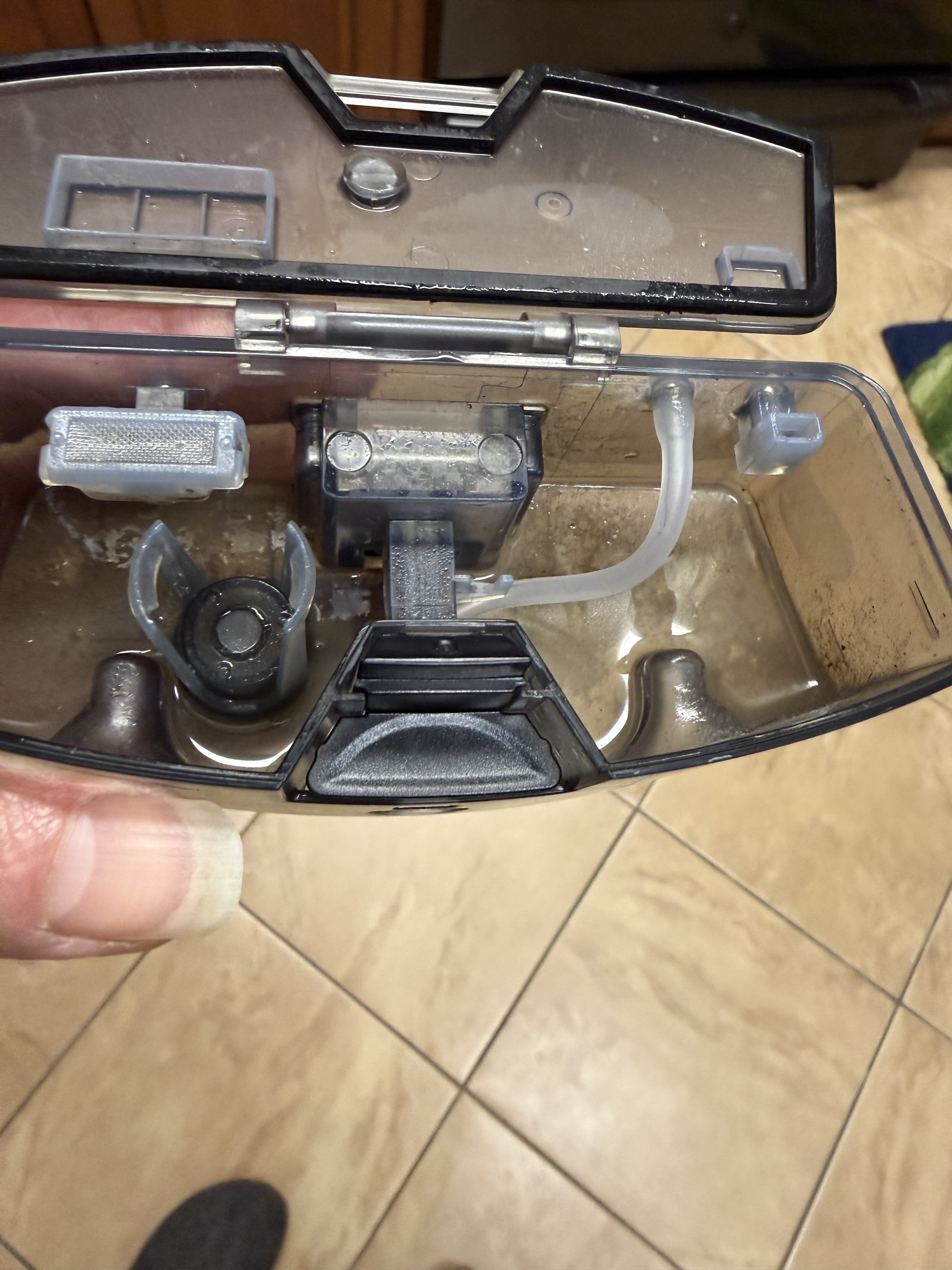

The used water box on the robot was pretty dirty and took a small brush to get it cleaned.  The spot that surprised me with probably the most dirt was when I removed the fluffing roller.  It's a little skinny bar that I guess fluffs the roller.  There was some hair wrapped around the end and underneath was pretty dirty.  I found that a Q-tip worked the best for getting the dirt out of that area.
The mop roller was completely dry, but it smelled really bad.  In the first photo, you can see some dark stripes on the roller mop - not sure if that is dirt or what.  It definitely was not going back on the robot.  I put a clean mop roller on and will try to wash this one by hand to see if I can get the smell out and be able to re-use it.  I would have expected it to be used longer than 3 weeks.  As a side note, I don't have the robot clean up spills or any messes.  It is basically just mopping paw prints off the floor, maybe some dried coffee stains, and just general dusty dirt.
