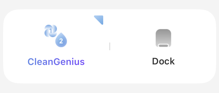

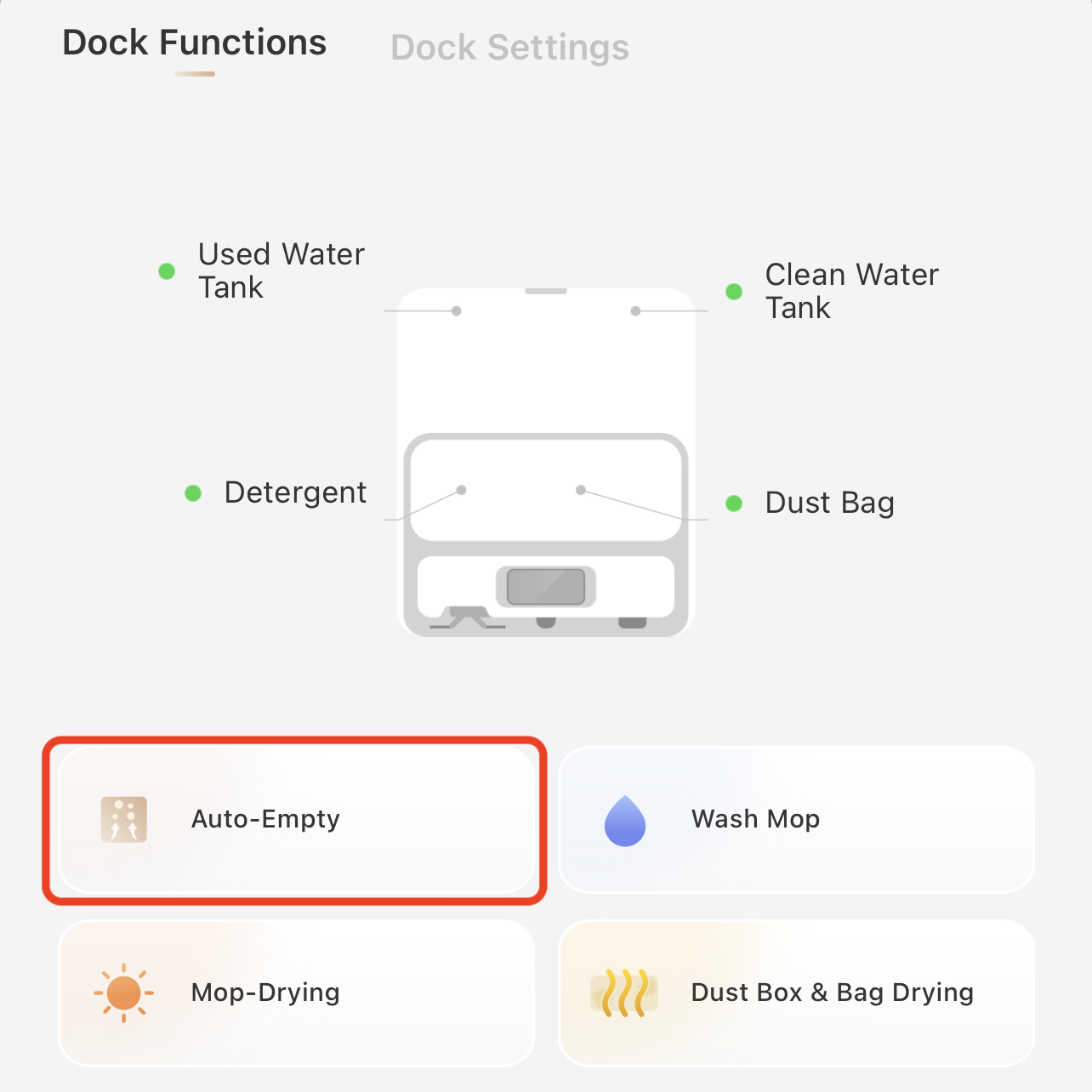

1) Run an Auto-Empty to ensure the dust bin is empty. This prevents any leftover dirt from spilling out of the bin while changing the filter.

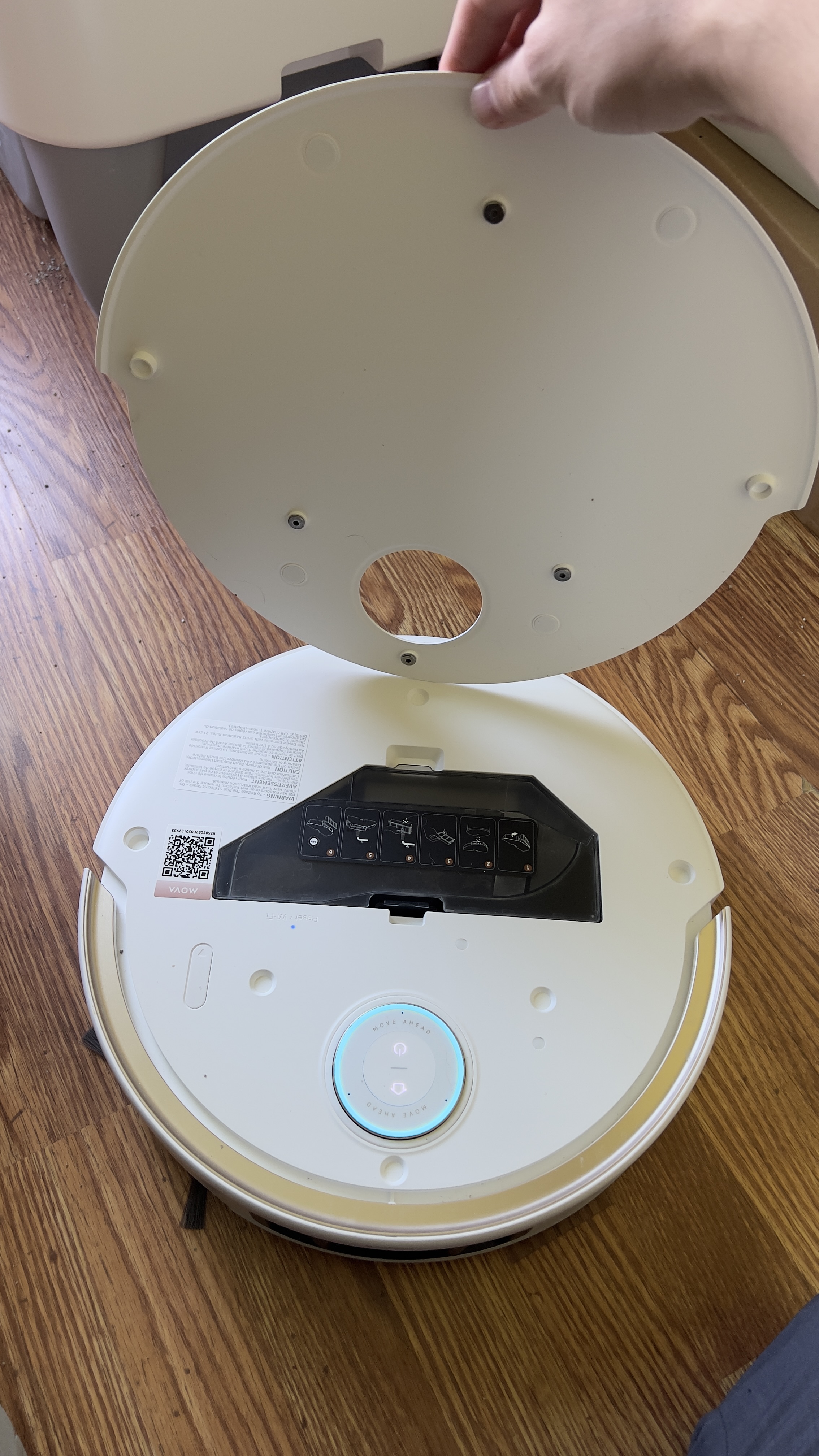

2) Remove the magnetic top cover. This was done during the first-time setup when scanning the QR code to connect the vacuum to Wi-Fi.

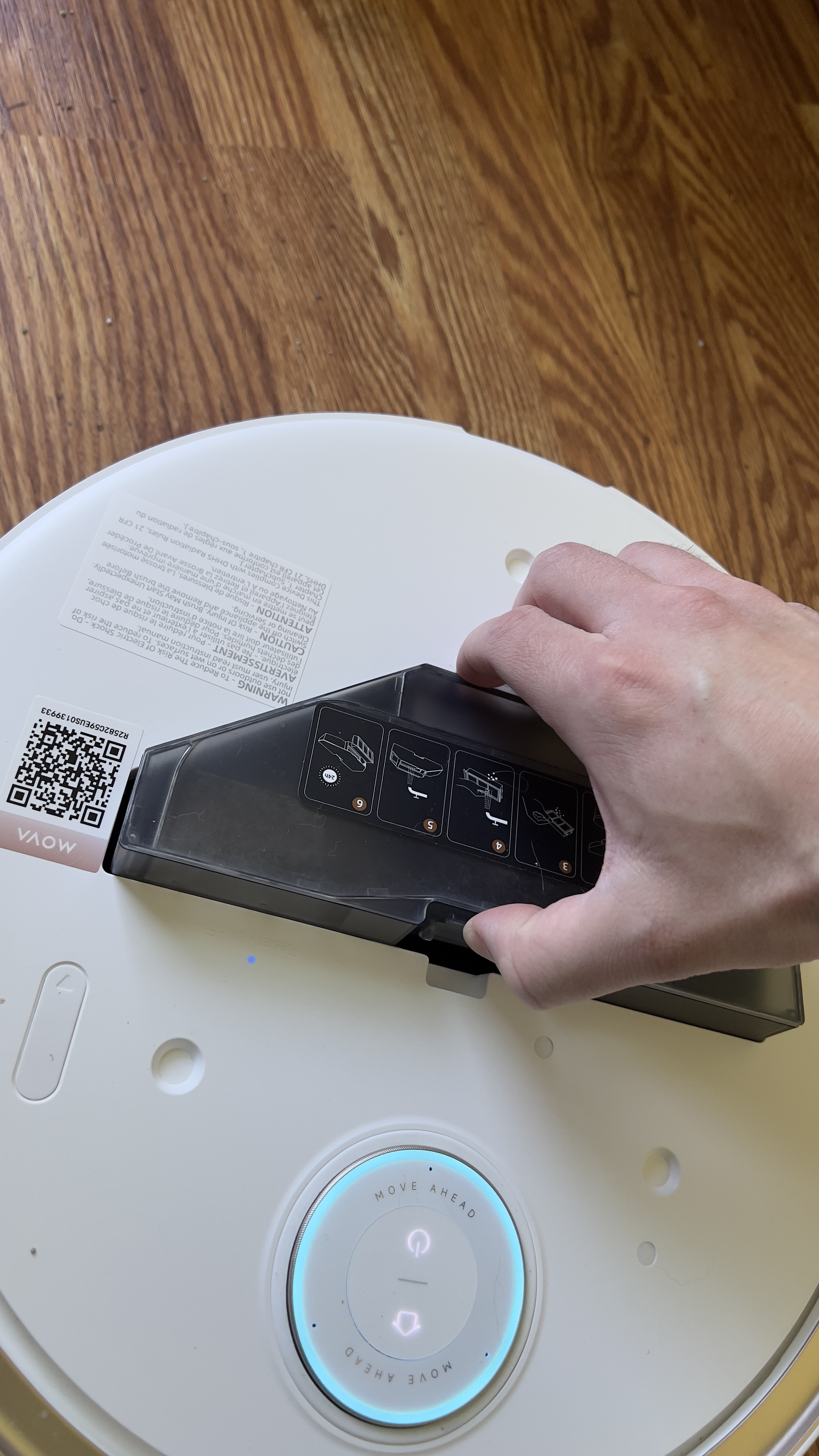

3) While holding the rear of the bin, pinch the tab on the LIDAR side of the container and pull the bin out.

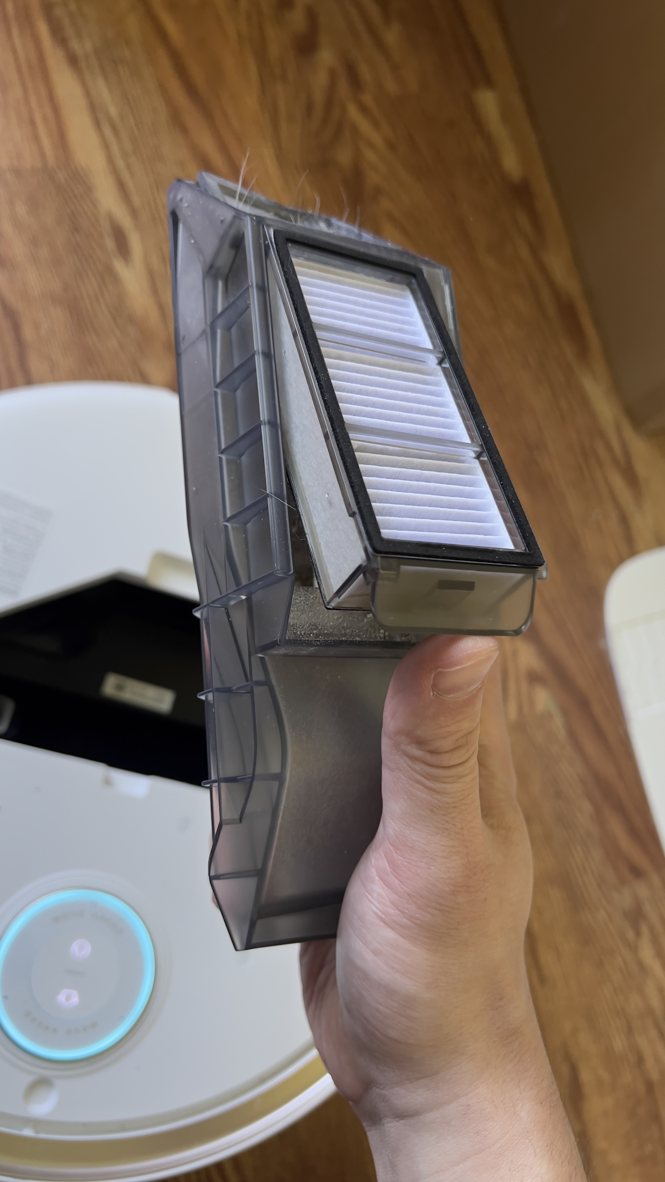

4) Remove the filter by unlatching the lock that's on the opposite side from the dust intake.
