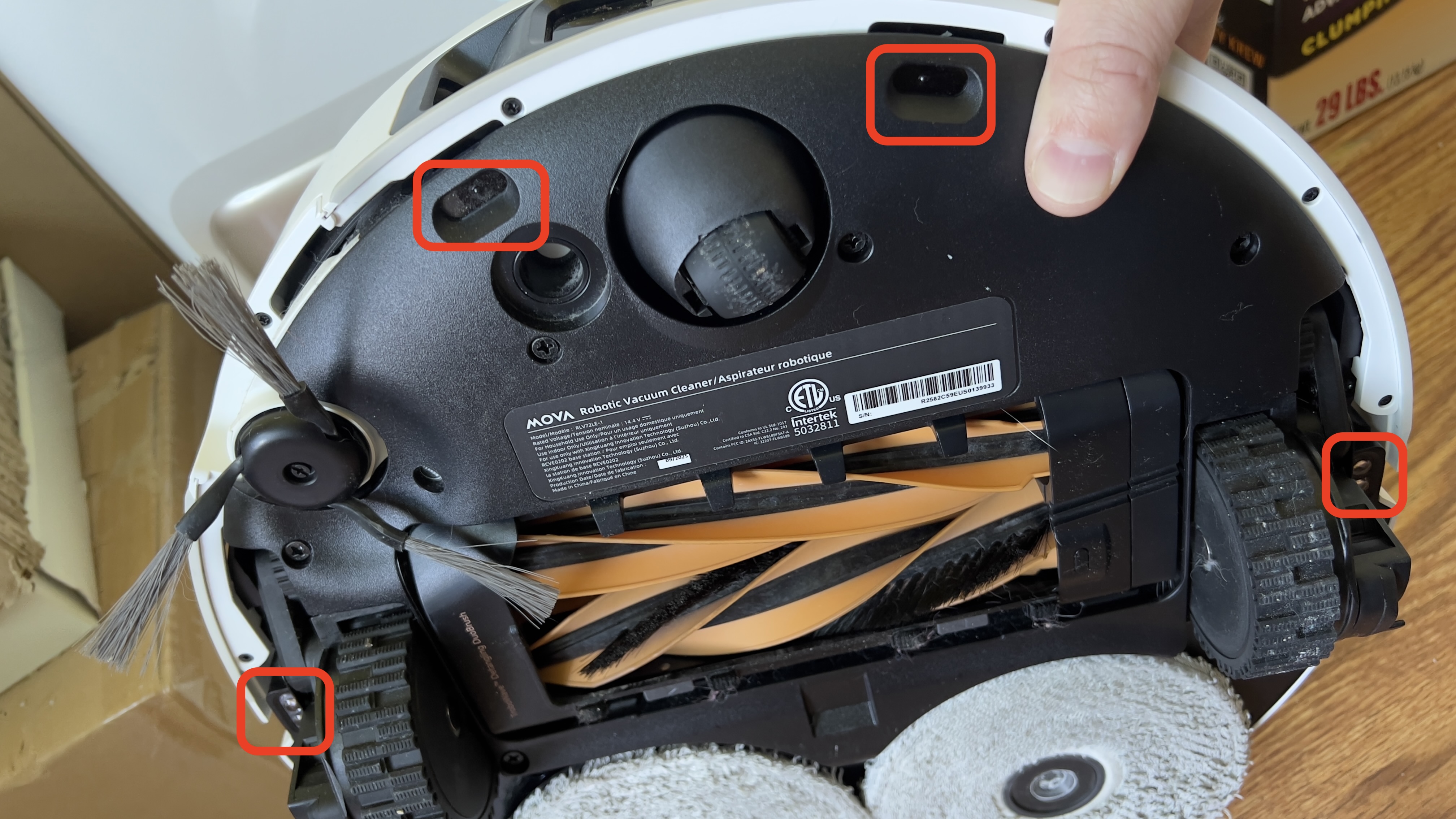

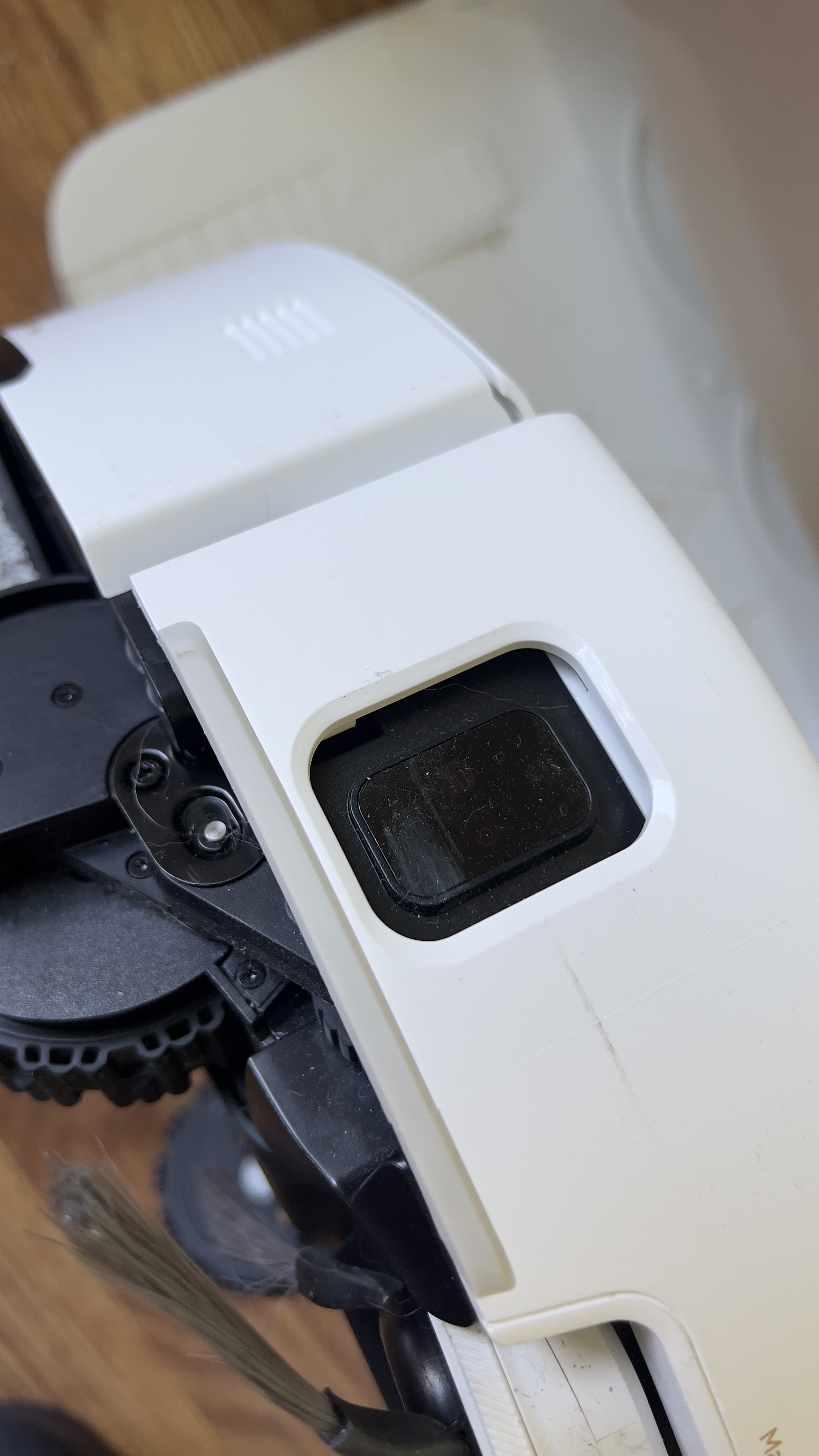

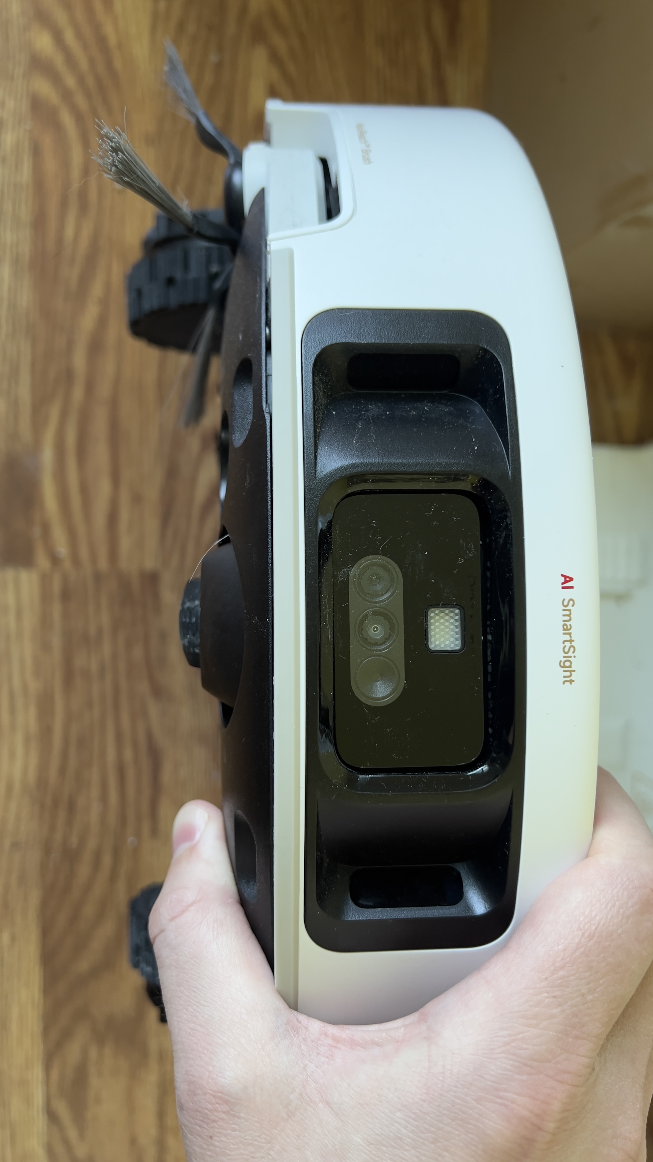

The V50 Ultra Complete is a robot of many eyes! Its main sensors are on the front and front-right corners, while the bottom features several other sensors to ensure it doesn't fall down stairs, among other tasks.
Over time, these sensors accumulate dust, which can impact the robot's performance, and will need to be cleaned off. To clean the sensors, simply wipe them with a microfiber cloth to remove any accumulated dust. If needed, lightly wet the cloth before wiping, then wipe the sensors with a separate dry microfiber cloth to remove any remaining liquid.
The attached images show where the sensors are; they're extremely easy to reach and clean!

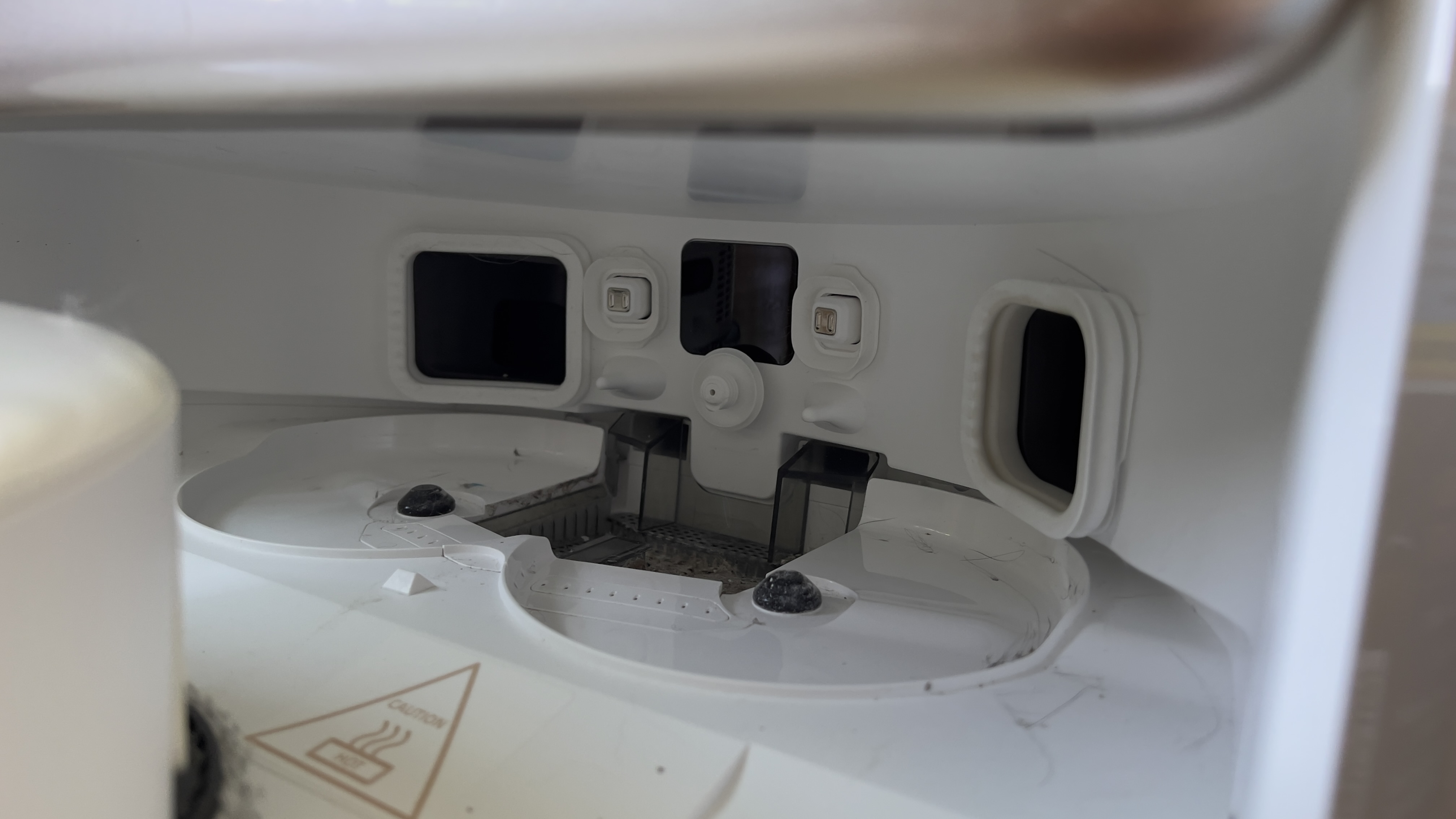

The dock also has a sensor on the back, between the charging posts. This also needs to be cleaned regularly to ensure the robot can find and return to the dock.
