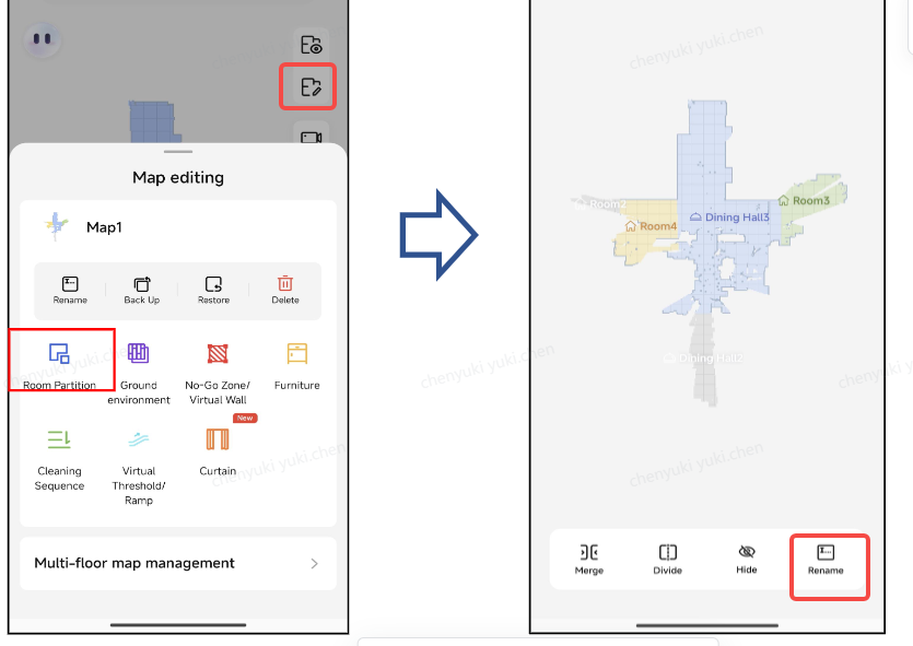

How do I change the names on the map?
Hello, I have already replied to you below. You can refer to the attached image to rename the room.
2026-1-5 09:34 US Translate
Please follow the steps below to rename the room.
Map editing icon — Room Partition — rename
Please note that only the primary account can rename rooms; shared accounts cannot.
