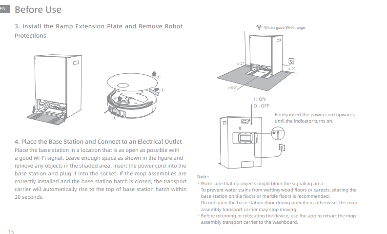

Please place the charging dock in an open area with good Wi‑Fi signal. Leave sufficient clearance as shown in the diagram and remove any objects within the shaded zone. Important: nothing should block the signal area.
To prevent water spillage from damaging wooden floors or carpets, place the dock on tile or marble flooring.
Do not open the dock door during operation, otherwise the mop carrier assembly will stop moving.
Before relocating the robot or dock, use the APP to retract the mop carrier back into the dock.
For full installation requirements, please refer to your user manual. |
