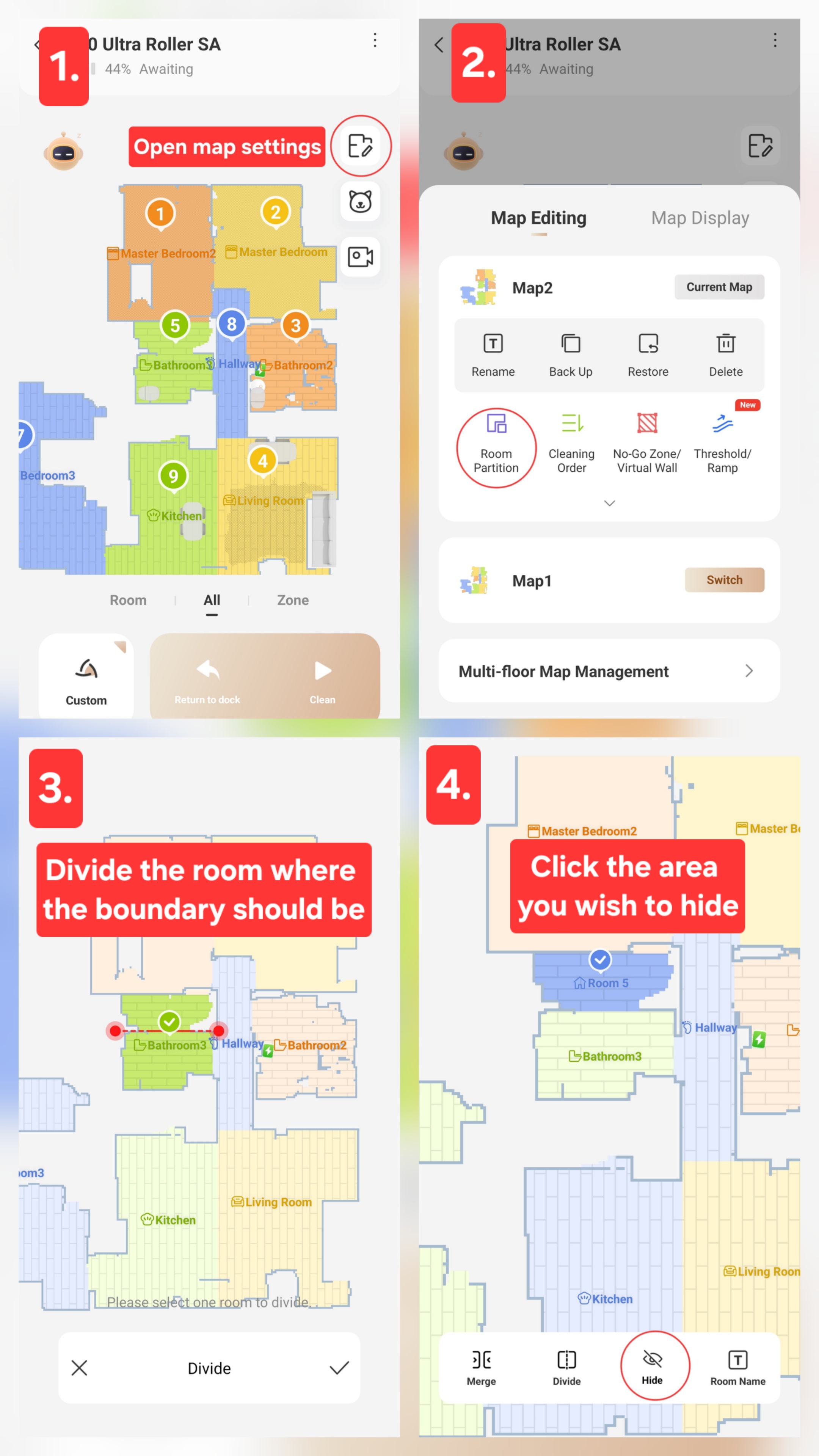

I like to use the "hide and divide" method
