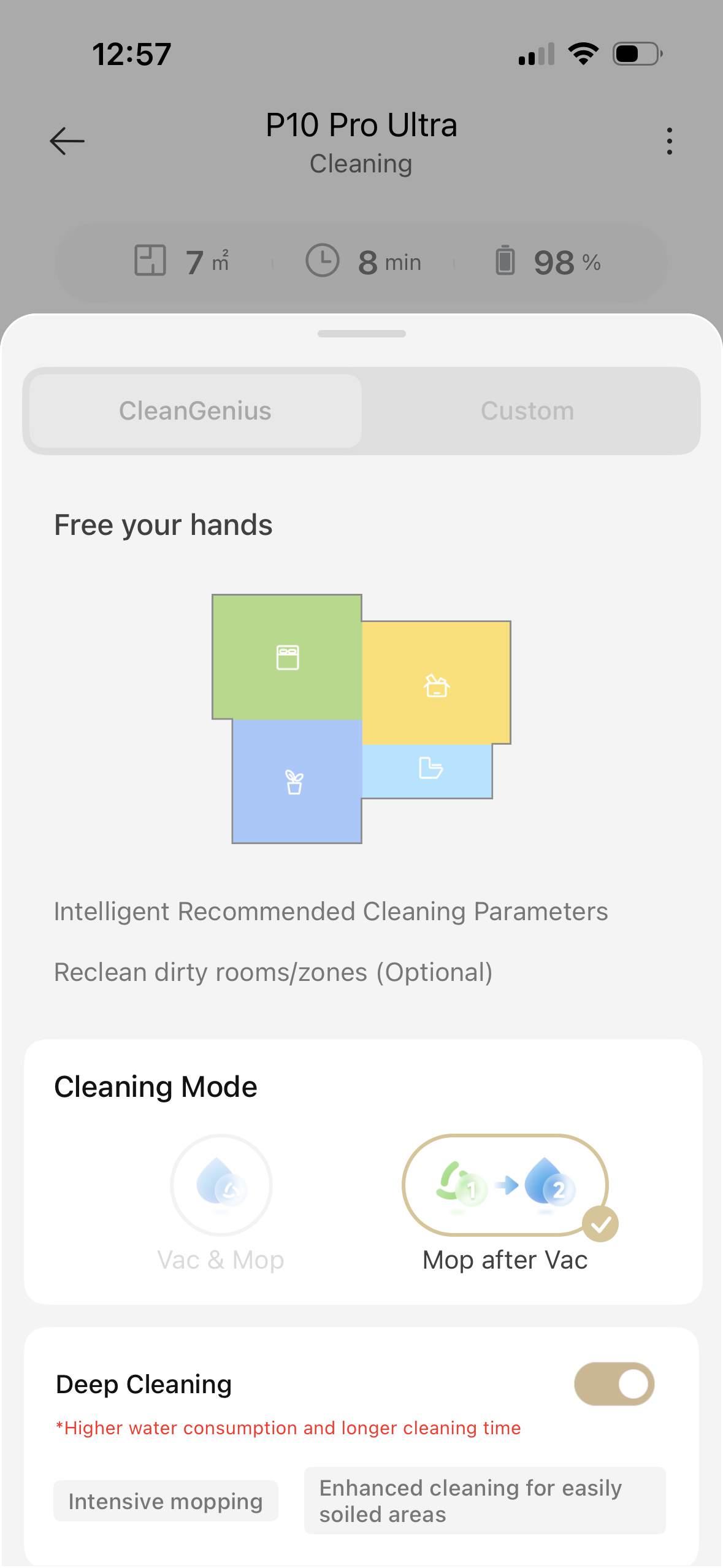

Has anyone else had problems while in Clean Genius mode lately that the vacuum just starts mopping a carpeted room completely?? I reached out to support and they are a bust… this is unusual as this model is designed to detect carpet.I have carpet in the rooms I sent it to minus the one bathroom. No excuse…

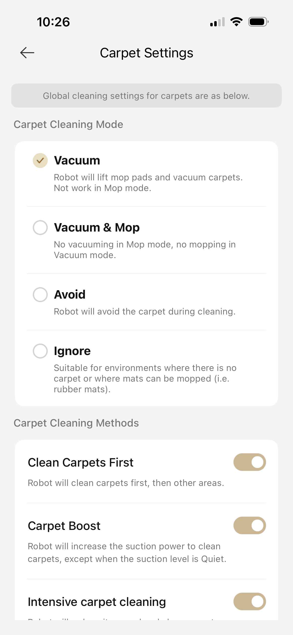

Thank you for your quick reply. To resolve this issue, we suggest you enable carpet‑avoidance in the settings or mark the carpet area as a no‑go zone and see if this works.

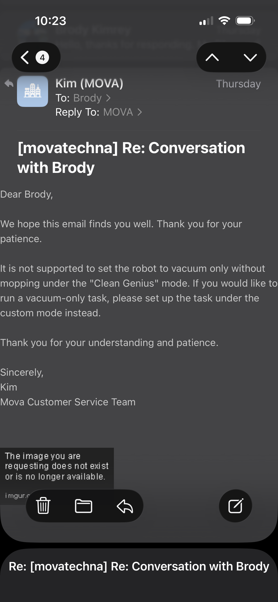

I temporary shared it with that account,  here is the setting I have, it should lift while in clean genius mode. Here is one of many random responses back from the support team. I need it to still vacuum my carpeted rooms, so I don’t think carpet no go zones would allow for that and my map would be cluttered with me doing that.

Hello, we have received and verified your ticket. To avoid duplicate communication, our after‑sales colleague will contact you first by email. Feel free to message us privately if you need further assistance.
