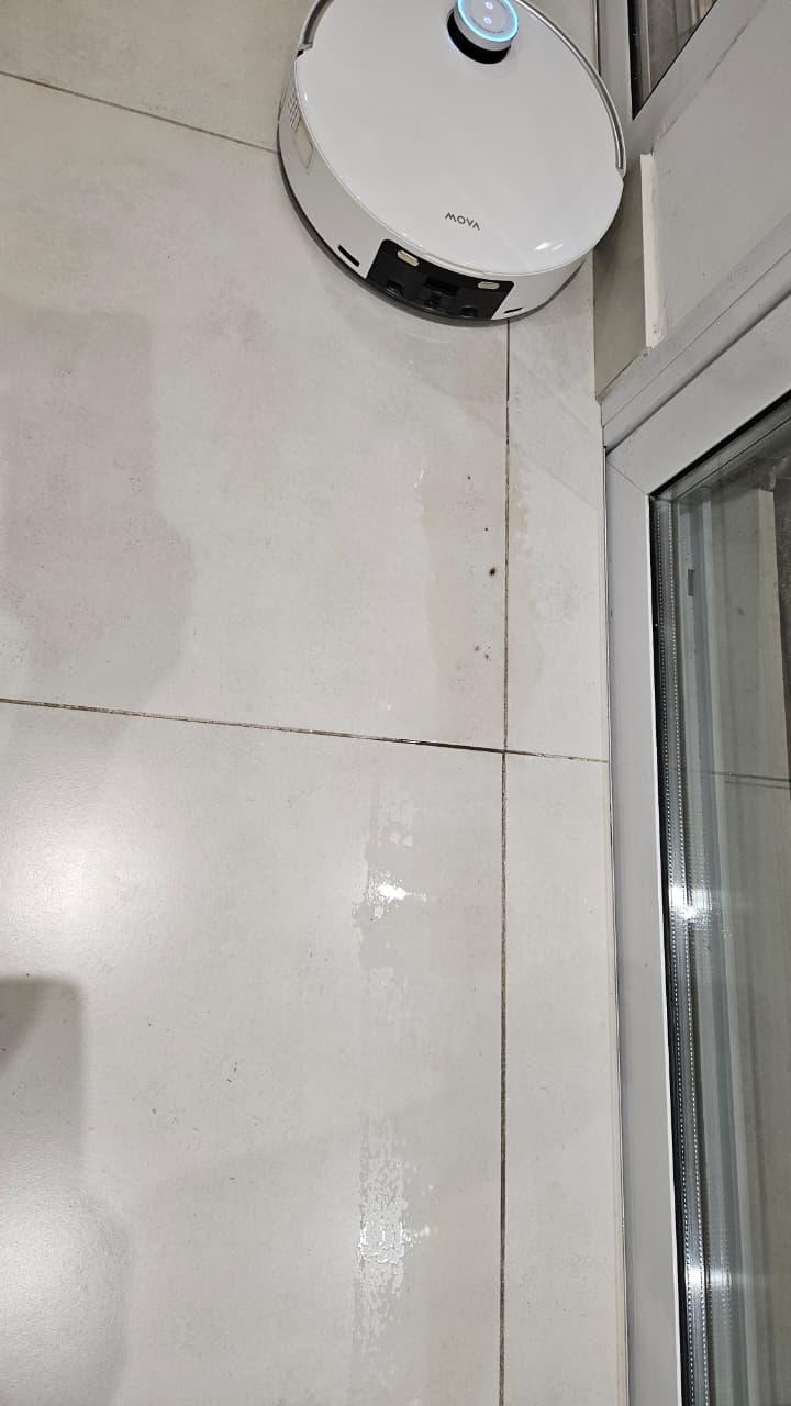

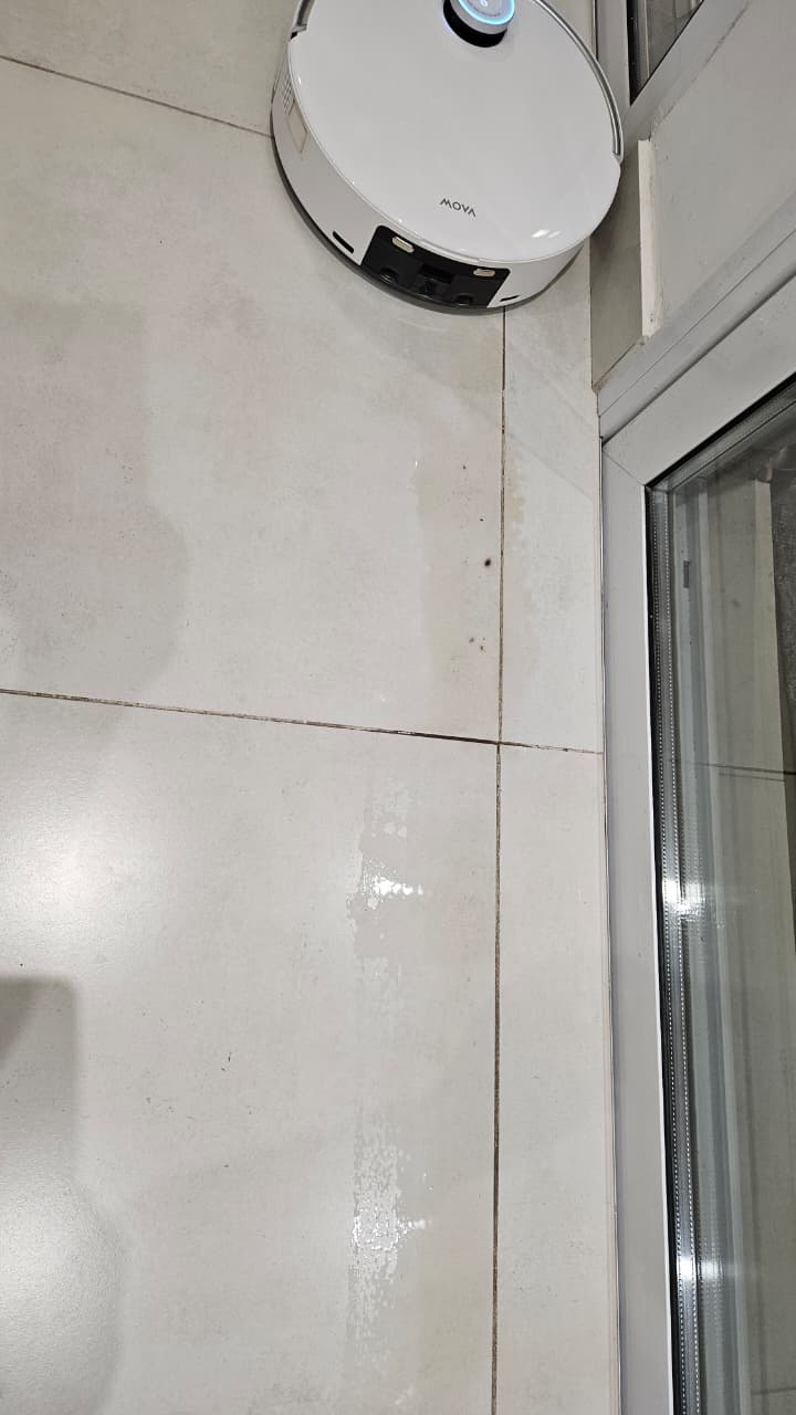

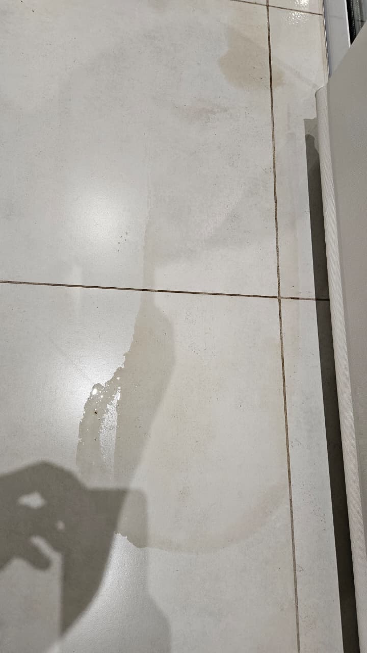

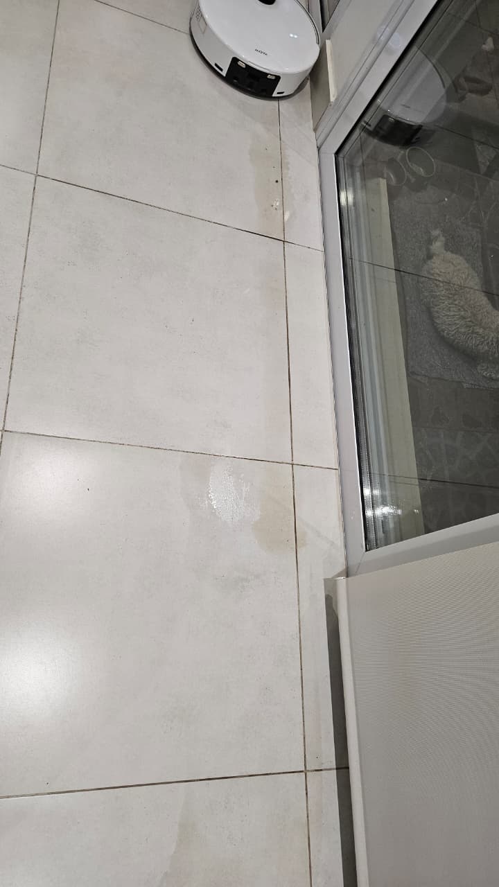

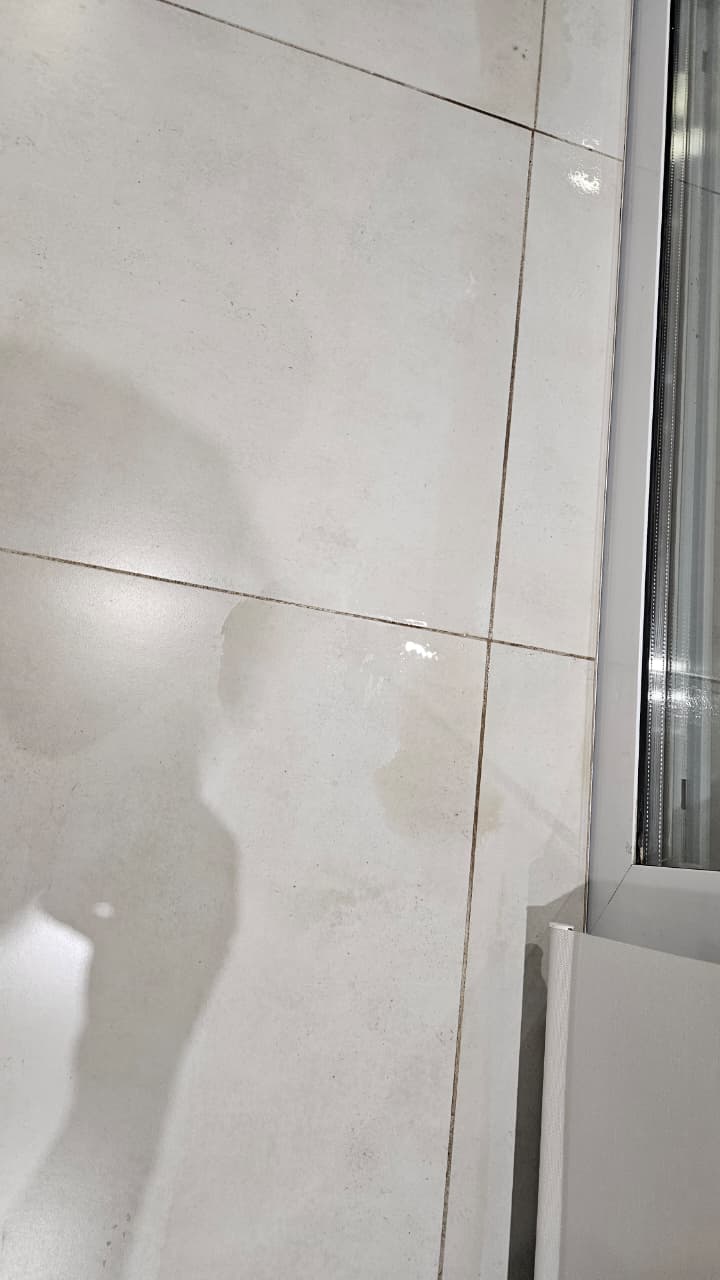

I purchased a Mova Z60 (SA now..) from Mova´s page in Amazon. I have been using it for more than one month and I have had several issues with the mopping system.
At home,  i vacuum before mopping to get sure that dust is removed before passing the roller but I have noticed after a couple of days dirty water spills after cleaning the roller before continuing with the task. I seems that the dirty water is not going or being sucked into the dirty water tank. I have started a cleaning process in Wet conditions to verify how much dirty water is being sucked into the tank but it stays almost empty which is impossible.
Also the roller gets dirty which seems that the dirt from it is not being removed when mopping. I am really disappointed with the product and want your support to troubleshoot whatever might be happening with the robot.
I attached some images of the spills but even if there are no spills, dirty water tank is always emty with the exception of the main clenaing process that leaves some water in the tank.

Regarding the "dirty water tank not collecting water" and "overflowing" issues you described, these are usually related to the seal of the water tank or the state of the suction port. We suggest you try the following steps for quick troubleshooting:
Check if the dirty water outlet and filter components are clogged, and clean them promptly.
Open the top cover of the dirty water tank to check if the sealing ring is loose or deformed. Ensure it is manually reset and clean it with a cloth.
After emptying the dirty water, make sure the tank latch is properly secured.
Press down on the dirty water tank after placing it back in the base station to ensure it is installed correctly.
If these steps do not solve the issue, use a dry cloth to wipe the liquid level sensor (metal shrapnel) on the cleaning tray.
If the issues persist after the above troubleshooting, please send the device's SN code, purchase invoice, and the photos of the issues you captured (as attached in the post) to our after-sales support team. Rest assured, we are committed to providing you with a satisfactory solution.
