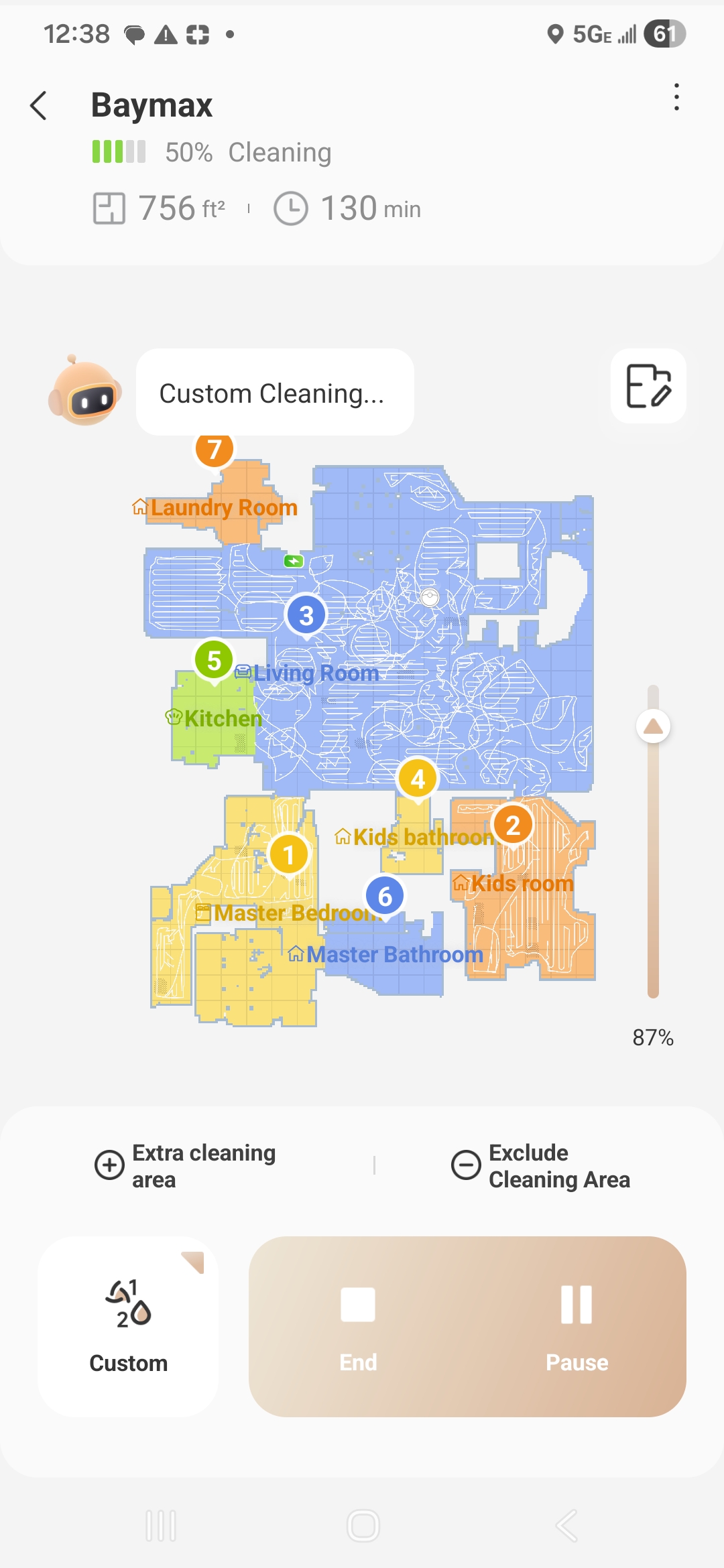

Does anyone know why my mova p10 gen 2 is skipping parts of rooms and also making crazy inefficient routes through rooms that are completely clean?
