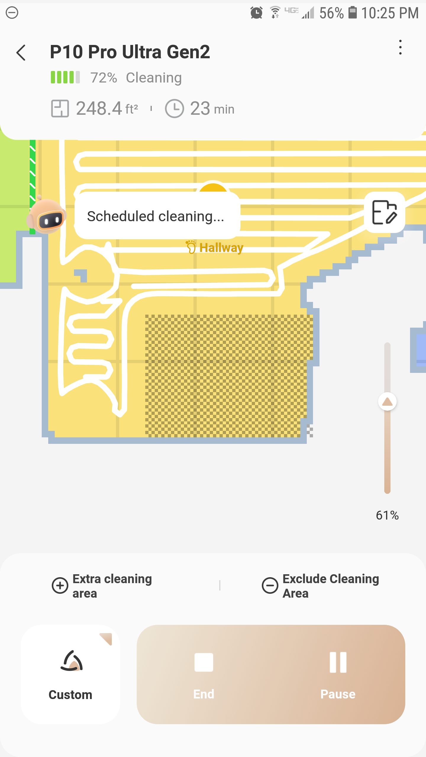

My new P10 Pro Ultra Gen 2 seems to be skipping rugs/carpet. My settings tell it to vacuum carpet. What am I missing?

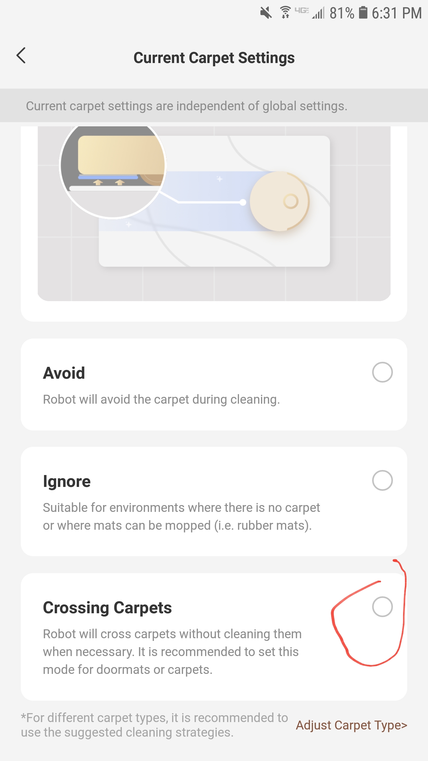

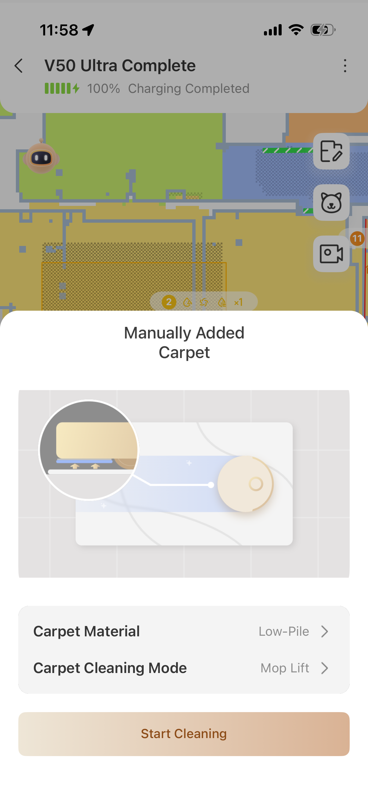

If it’s a manually added carpet by you, physically click on the hashed area on the map/the carpet itself to access additional settings related to that carpet.

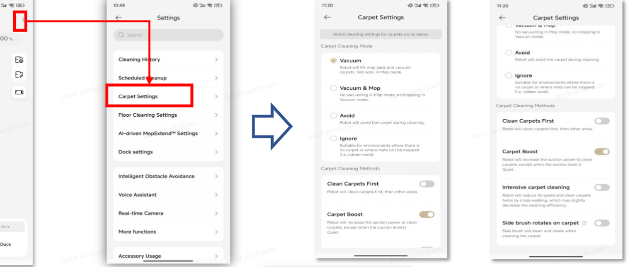

Please first check your carpet cleaning settings to see if you've selected to avoid or ignore carpets (as shown in the picture).

Mova King!: Thank you! I believe you were correct! My global setting was set to clean the carpet, but the setting for the manual carpet was set to skip if necessary. I switched it to match my global setting and it cleaned the carpets!
