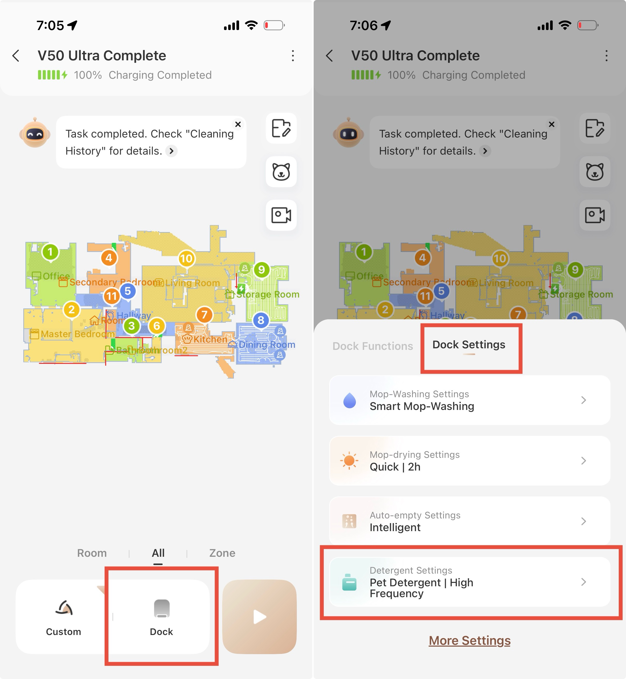

I have had the V50Ultra for a few months now and love the machine.  It works great however I did notice when cleaning it that the pet odor and cleaning solution does not seem to be going down any so am wondering if there is something that I am missing in the set up or if there might be an issue to if it just uses very very little.  Any insight would be appreciated.

The detergent tank on the V50 Ultra Complete lasts much longer than most people expect because the solution is highly concentrated. Typically, it only dispenses about 1–2 mL per cleaning cycle, so it's normal for the level to drop very slowly.
A few things you can check:
* Make sure the front gold-colored cover is fully closed, as this helps seat the detergent cartridge correctly.
* In the app, verify your detergent concentration/dosage setting and increase it if you'd like the robot to use more solution (photo attached)
* After a mopping cycle, gently shake the dirty water tank. If you see some foam, that's a good indication the detergent is being dispensed.
If you've gone through several mopping cycles and the detergent level still hasn't changed at all, it may be worth reaching out to MOVA Support with your SN number so they can help determine if there's an issue with the dispenser.
