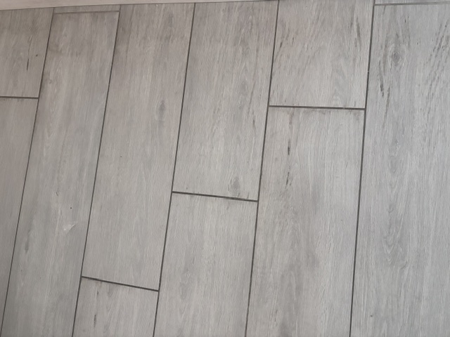

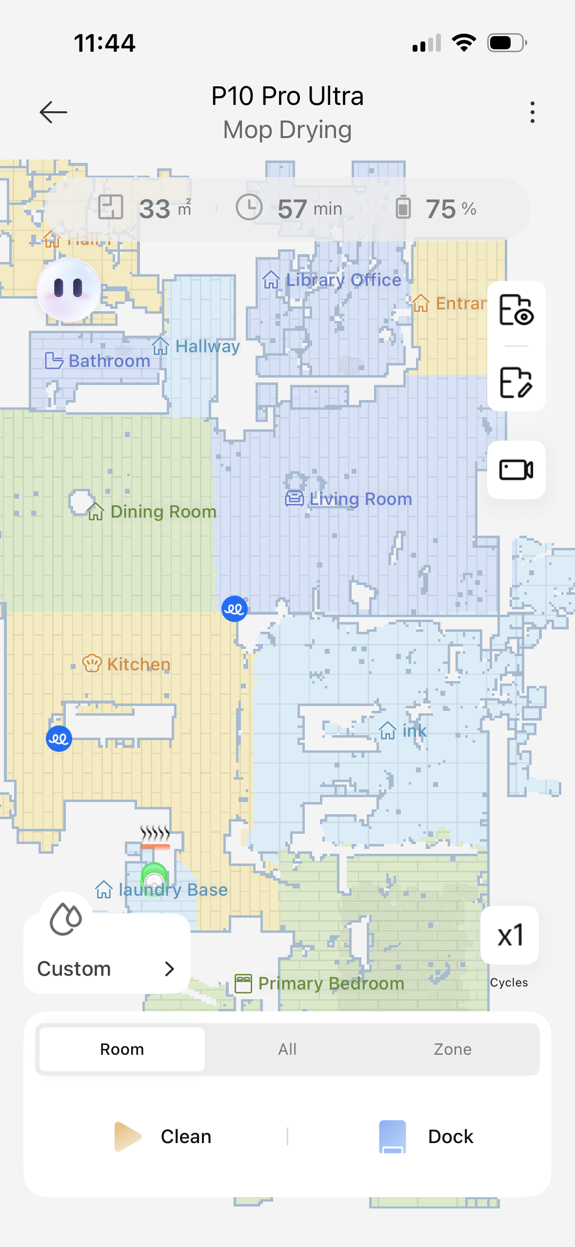

I mapped my single-story home and in Floor Cleaning Setting selected clean along the floor direction.  In Custom Room select and an extra section; the robot is NOT mopping in the direction assigned.  In the mode "Clean up here" the robot does a box in the area and cleans in horizontal and vertical directions, again not in the direction intended in the app.  In Room cleaning mode, the robot does a perimeter box first, again not in the direction, and starts cleaning. This is causing a dirt to get caught in the tile grooves and making the floor appear to have dirt streaks.  How can I get the robot to clean in the correct direction?

Hi there, thanks for reaching out with this detailed feedback about your mopping direction issues!First, when you enable the **mopping along floor grain** feature in Floor Cleaning Settings, there will be a small prompt note: if an area needs repeated cleaning, the robot will use a cross bow-shaped cleaning path to ensure thorough cleaning results.
After checking your cleaning records, we found that manually started cleaning tasks follow your set floor grain direction perfectly. The cross-direction cleaning only happens in your scheduled cleaning tasks: you've set **twice-daily repeat cleaning** for your living room, dining room and kitchen in the schedule, which triggers the cross bow-shaped path for the second round of cleaning.
You can try adjusting the scheduled cleaning frequency to **one single cleaning per day** for these zones, and the robot will stick to your preferred floor grain direction consistently. If you have any further questions after the adjustment, feel free to let us know!

Hi Thank you for the update. Allow me to clarify. My daily cleaning is vacuuming only and not mopping. I do not have a mop schedule set; only the vacuum. During the day I may send the robot out to MOP selected areas. When I do this, the robot first makes a box. When it does the box, it is running against the grain of the tiles, the robot will then do a cross hatch in which it also will go against the tile slots. Please advise. Thanks
