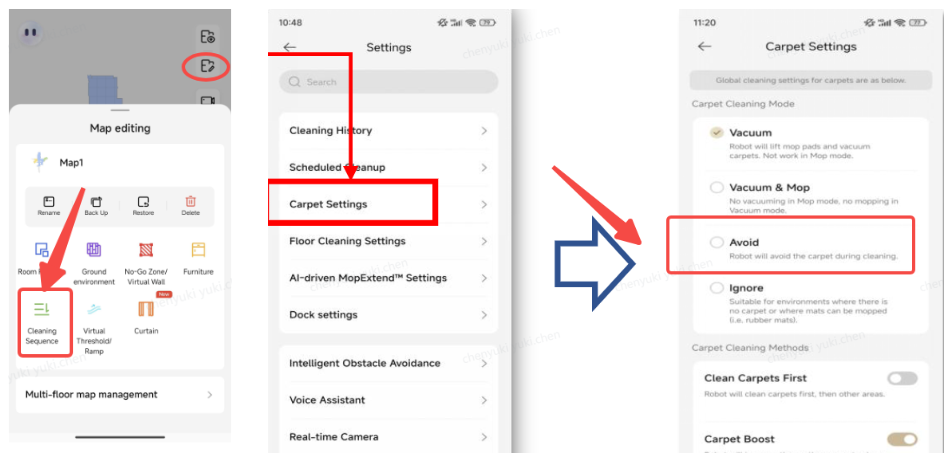

I received the Movo Pro50 Ultra as a Christmas gift.  We set it up to map the downstairs.And then I changed the room order to the order of rooms I would like cleaned. However, it goes back to how it mapped the downstairs. How can I program it to do the rooms in the order in which I would like to have them done? Also I have rugs in some of the areas that need to be mopped.  How do I make sure that it doesn't mop over the rugs?
For setting the cleaning order, please refer to the screenshot for guidance.
Make sure there are no obstacles blocking the robot’s path between rooms, as this may disrupt the intended cleaning sequence. Additionally, if the robot is operating in Clean Genius mode, it will automatically determine the cleaning order of the rooms.
To prevent the robot from mopping over carpets, you can go to the carpet settings and select the “Avoid” option. Once this option is enabled, the robot will skip carpeted areas during mopping.
