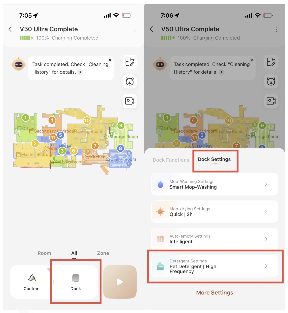

* In the app, verify your detergent concentration/dosage setting and increase it if you'd like the robot to use more solution (photo attached)

Photo - sorry forgot to attach!
