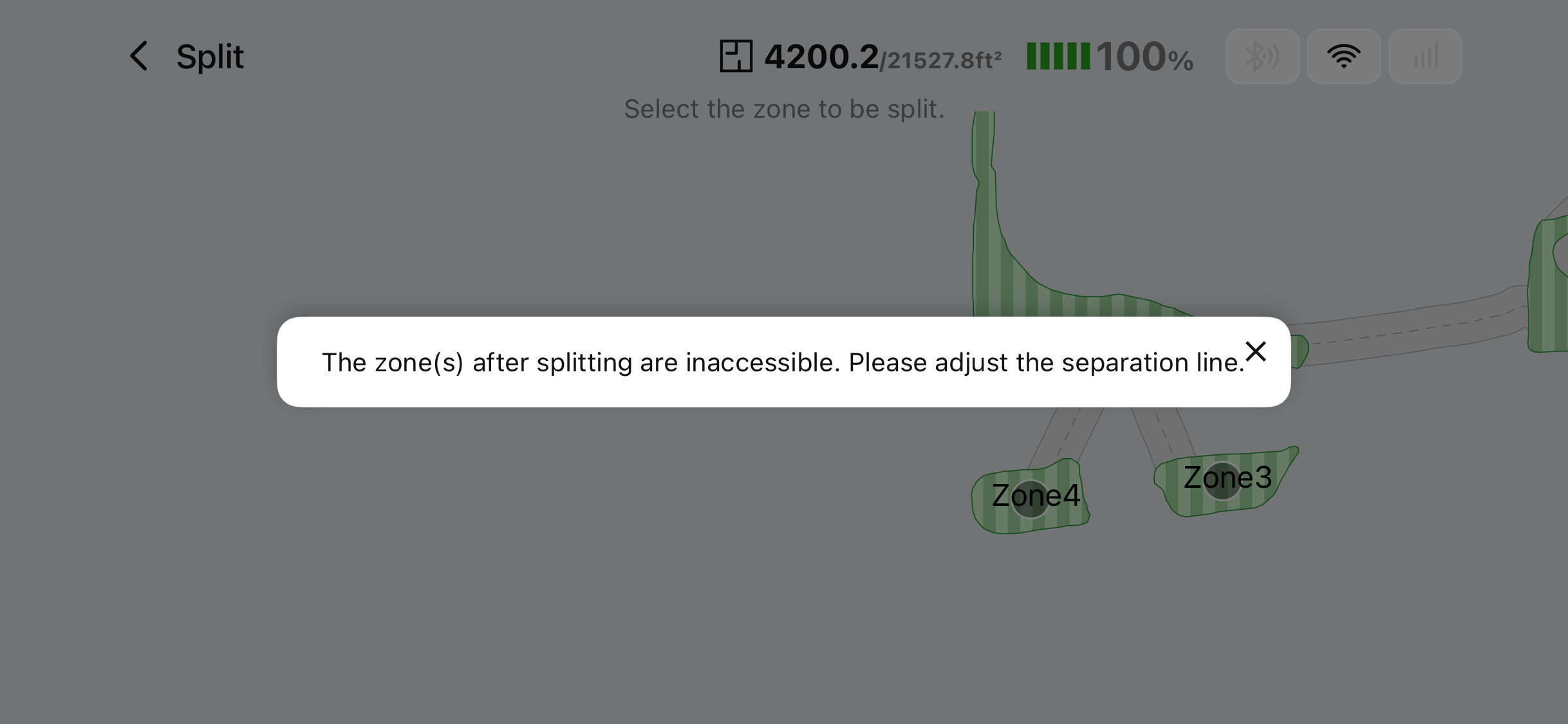

I have just got my 2000AWD working. My yard has two thin areas, one North-South and one East-West.  I mapped them separately, but they were combined when the map finalized. I can't find a setting for "mow the long direction", direction is a compass heading. Ok, there is a "Split Zone" function. I will make two zones and set a separate mowing direction.  I get the little red line and split them up.  I drop the line and get "The zone(s) after splitting are inaccessible. Please adjust the separator line."  What does this mean?  I want the zones to be separate, that's the point.  I could add a path between them if that's needed, but all the other places I needed a path it said that and let me add one.  This wants me to move the line, and doesn't seem to know where.  Usually there is a little picture showing what to do, but not here.  The mower doesn't like to mow a narrow strip in the narrow direction as it requires many, many 180° turns.

Here is the error message screenshot.

KF457975Thread Starter
I moved the line around, and didn't get the error. It seems like I cut the zone where it was too narrow.  The message didn't say that, so it's still just a theory.
