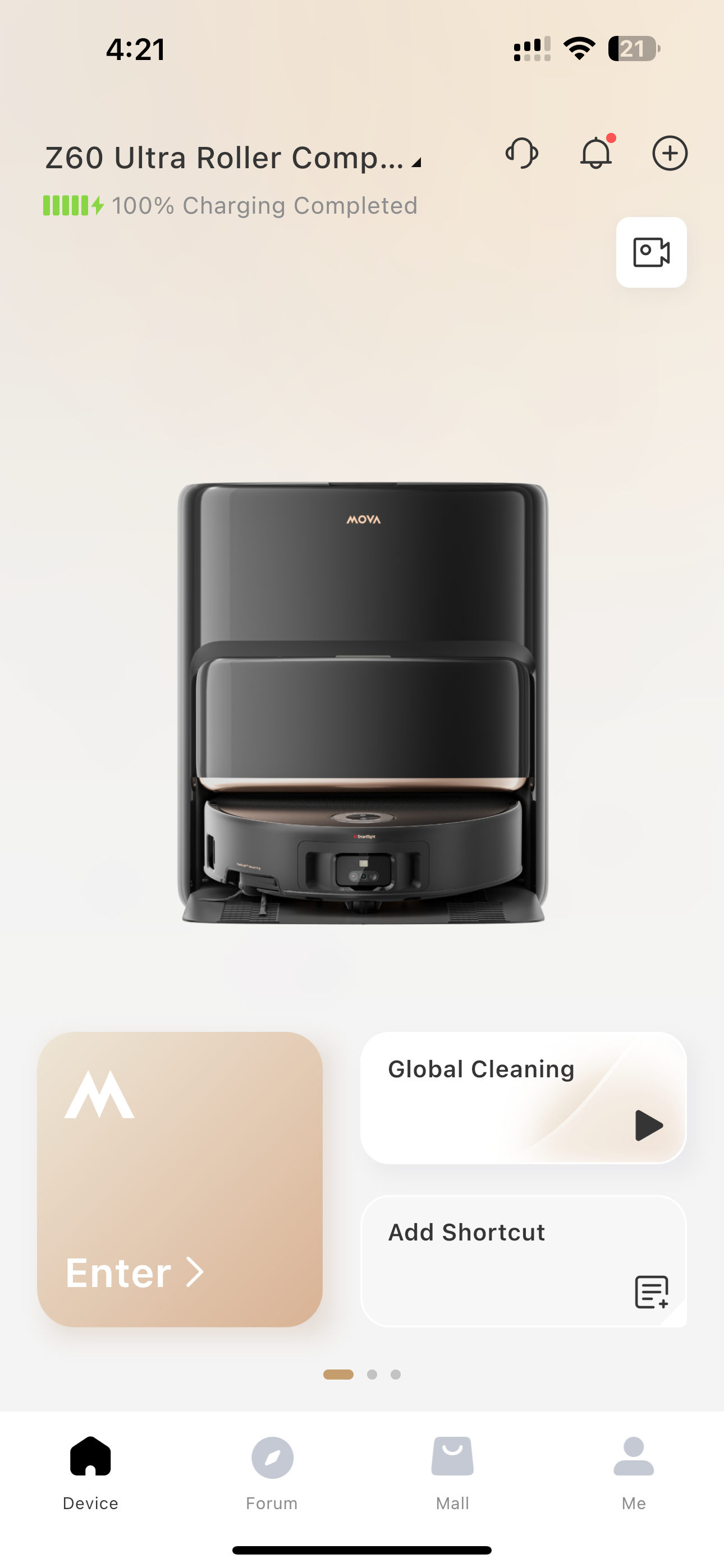

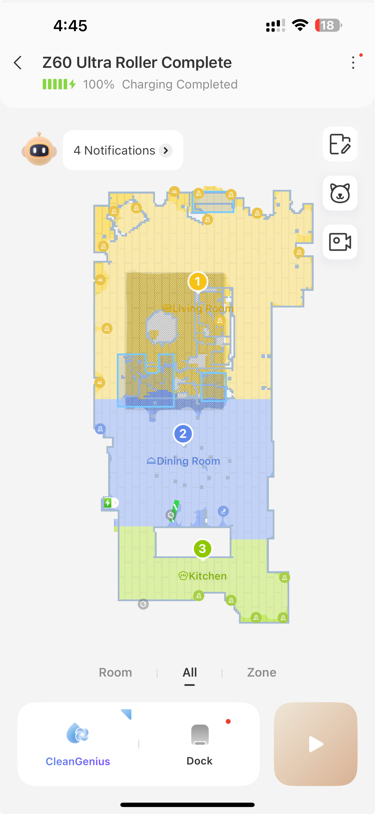

Open MOVAhome and your first view isn't a map. It's a clean device card showing your robot, current charge status, and a one-tap Global Cleaning button. The most common action (just run it) is right there without needing to go anywhere. Tap Enter and you're into the full map view. You do need to run a quick mapping pass first, but once the Z60 built my map it auto-identified all three rooms and labeled them correctly without me having to draw or rename anything. CleanGenius lives right on the main map screen, no hunting for it, and there's a dedicated pet icon in the sidebar leading into a surprisingly robust pet feature set. The Room/Zone/All toggle at the bottom sounds minor until you realize how often you just want to clean the kitchen without doing the entire floor.

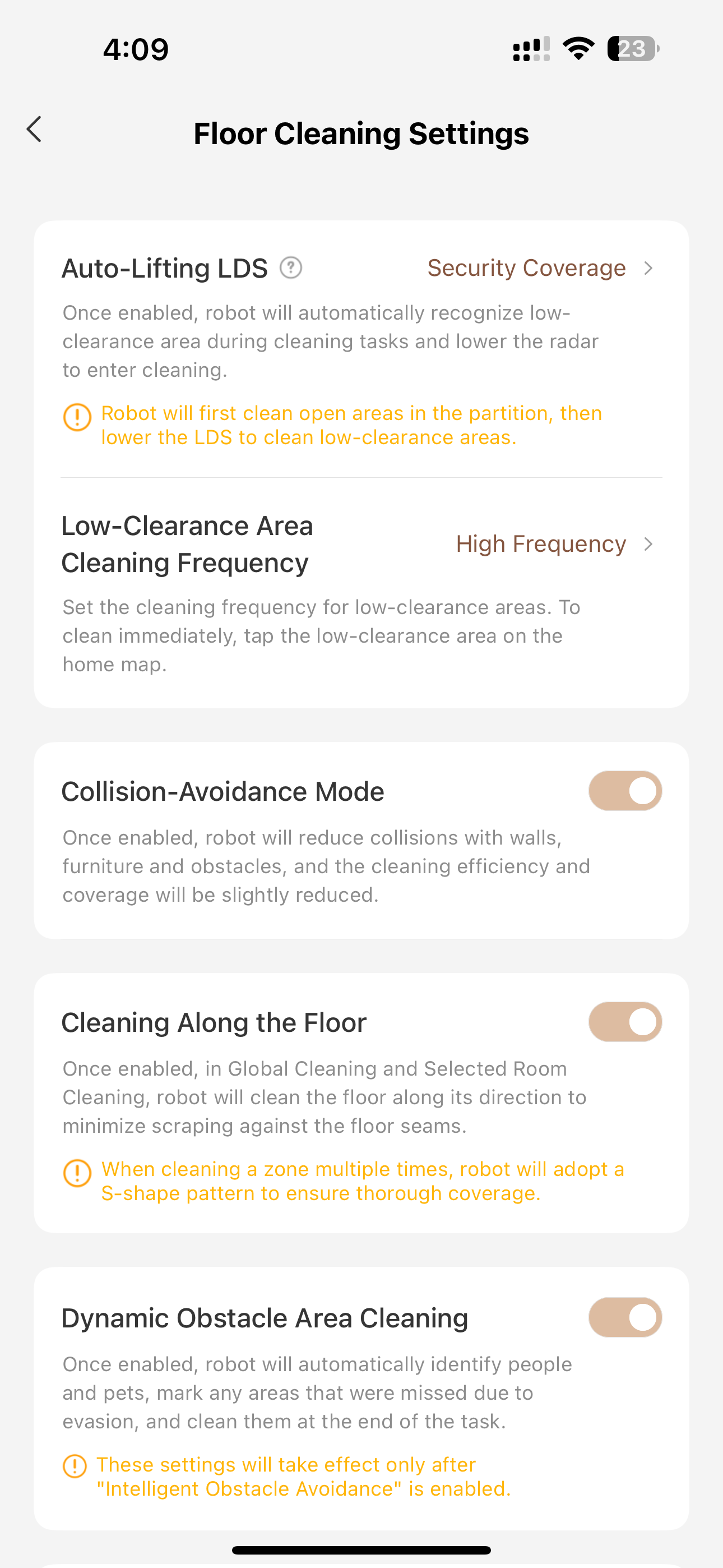

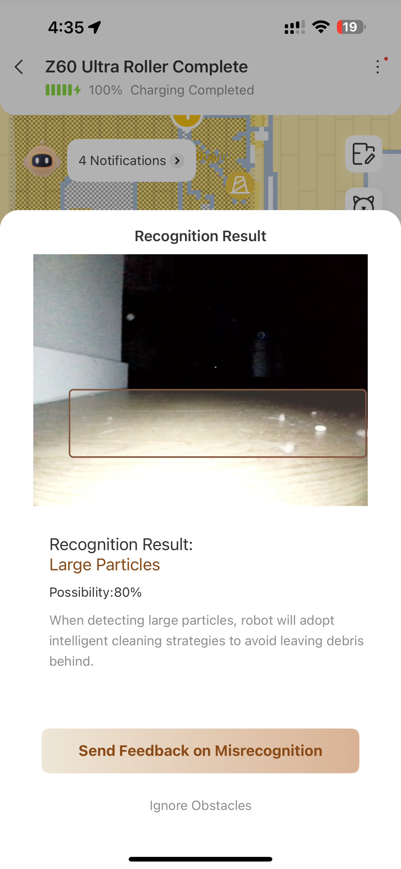

Floor Cleaning Settings is where a lot of the Z60's AI muscle lives and where most people probably never go. Collision-Avoidance Mode, Cleaning Along the Floor (which aligns the cleaning path with your floor direction to minimize scratches), and Dynamic Obstacle Area Cleaning are all on for me. That last one makes the robot go back and re-clean any spots it had to detour around due to obstacles, including people and pets. Important note: Dynamic Obstacle Area Cleaning requires Intelligent Obstacle Avoidance to be enabled separately, and there's an orange warning in the app telling you this. Good example of settings that are interconnected but not obviously so. Also in this section: two features labeled "Laboratory Functions." Intelligent Stain Cleaning and Large Particles Boost. I have both on. I actually appreciate that MOVA calls these out explicitly as experimental rather than quietly shipping half baked features with no disclaimer.
Edge & Corner Cleaning Settings has two toggles that matter a lot: AI-driven SideReach and AI-driven MopExtend. Both are on for me at High Frequency. SideReach dynamically extends the side brush into corners and against walls. MopExtend does the same with the roller mop. The already-wide roller extends further to get actual wall-contact coverage. I've watched this happen in real time and it works really well. Pro tip: place your furniture on the map before running. The more edges the robot knows about, the more opportunities it has to actually trigger the extend features. Without furniture added, it's mostly extending along walls.

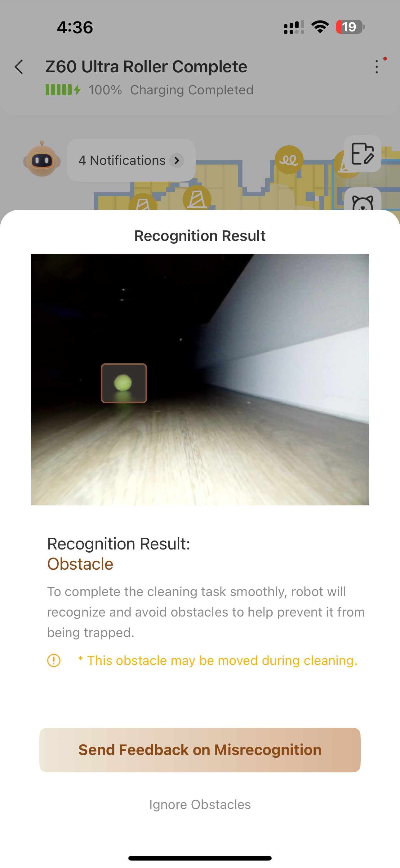

Intelligent Obstacle Avoidance is the master toggle for the camera-based AI avoidance system. I turned on Pictures (lets you see what the robot flagged as an obstacle) and Fill Light (auto enables an onboard LED in low-light conditions). The fill light doing its job at 3am in a dark room is one of those small details that adds up.

I expected good mapping. I expected room labeling. What I didn't expect was the Z60 actually detecting and marking large particles on the live map during a run. You can see flagged debris locations in real time. That level of environmental feedback through the app is beyond what I've seen on other robots I've used.
