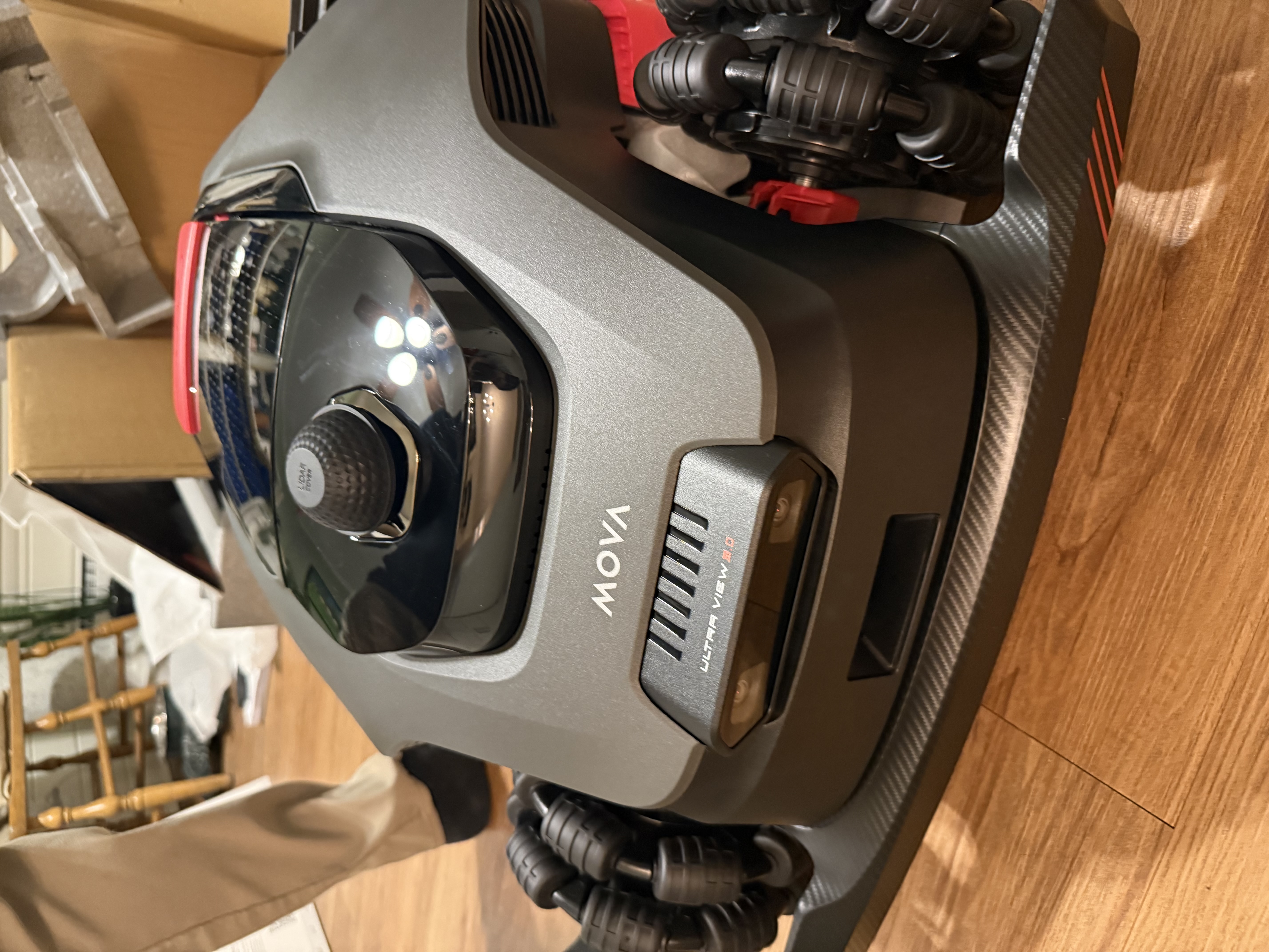

The unboxing experience was excellent and very similar to what I experienced with MOVA’s robot vacuums.
One thing I appreciated immediately: MOVA includes 36 extra blades and screws right in the box. That’s a small detail, but it means you’re not immediately going online to order replacements before you even start using the mower.

Just like MOVA’s vacuums, the mower uses an AI mapping process, powered by onboard LiDAR, to create a digital map of your yard without needing perimeter wires or RTK GPS poles.

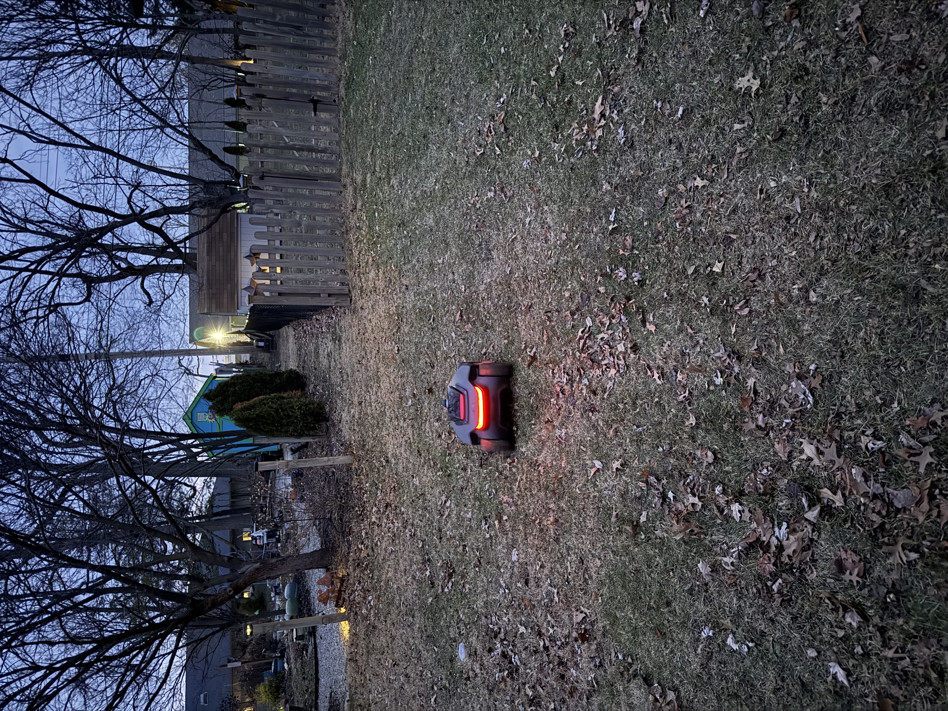

So far, the mower has handled my yard surprisingly well.
Despite the slopes, exposed roots, leaves, walnuts, and sweet gum seeds, I haven’t had a single situation where the mower became stuck or failed to complete a job.
Obstacle detection has also been impressive overall. The mower recognizes and avoids things like:
* people
* pets
* drain pipes
* larger yard objects
When it encounters something new, it actually takes a snapshot of the obstacle in the app and suggests that you mark the area as a no-go zone for future runs. That means the mower gradually learns your yard layout and improves over time, which is a really smart approach.
Very small objects like low sticks or dog waste can still be harder for the system to detect if they’re extremely low to the ground, but overall avoidance has been very reliable.

Since it’s still late winter / early spring here in Indiana, I haven’t been able to fully test the mower during peak grass growth yet. However, I’ve still run several mowing sessions and a few things stand out already.
The mower covers the yard very efficiently and doesn’t leave random missed patches. When it finishes, I can clearly see clean mowing lines across the lawn, which looks surprisingly satisfying.
Another nice feature is that the cut pattern can automatically vary between runs, preventing the mower from repeatedly stressing the grass in the exact same direction every time.
Even with leaves and seeds in the yard, it handles them without any issue, chopping them up and continuing the job.
